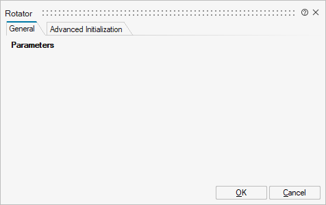

Rotator
Rotates space phasor
Modelica/Electrical/Machines/SpacePhasors/Blocks
Rotates a space phasor (voltage or current) inputu by the angle in negative mathematical direction. This block represents the transformation of one space phasor u from one rotating reference (coordinate) frame into another where the space phasor is y. The output reference frame leads the input reference frame by angle angle.
mo_n | n | Number of inputs (= number of outputs) | Scalar |

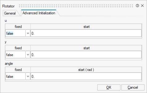

mo_u | u | u | Structure | |
mo_u/fixed | fixed | Cell of vectors | true | |
mo_u/start | start | Cell of vectors | ||
mo_y | y | y | Structure | |
mo_y/fixed | fixed | Cell of vectors | true | |
mo_y/start | start | Cell of vectors | ||
mo_angle | angle | angle | Structure | |
mo_angle/fixed | fixed | Cell of scalars | true | |
mo_angle/start | start | Cell of scalars |
