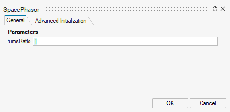

mo_turnsRatio | turnsRatio | Turns ratio | Scalar | |
mo_TransformationMatrix | TransformationMatrix | Matrix of size 2xN | ||
mo_InverseTransformation | InverseTransformation | Matrix of size Mx2 |

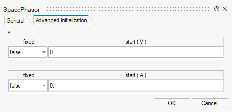

mo_v | v | v | Structure | |
mo_v/fixed | fixed | Cell of vectors | true | |
mo_v/start | start | Cell of vectors | ||
mo_i | i | i | Structure | |
mo_i/fixed | fixed | Cell of vectors | true | |
mo_i/start | start | Cell of vectors |
