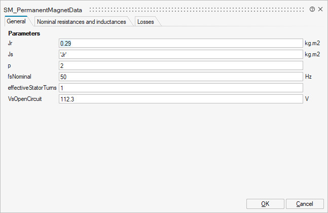

Basic parameters of synchronous induction machines with permanent magnet are predefined with default values.
SM_PermanentMagnetData_0
mo_m
m
Number of phases
Scalar
mo_Jr
Jr
Rotor's moment of inertia
Scalar
mo_Js
Js
Stator's moment of inertia
Scalar
mo_p
p
Number of pole pairs (Integer)
Scalar
mo_fsNominal
fsNominal
Nominal frequency
Scalar
mo_effectiveStatorTurns
Effective number of stator turns
Scalar
mo_VsOpenCircuit
VsOpenCircuit
Open circuit RMS voltage per phase @ fsNominal
Scalar

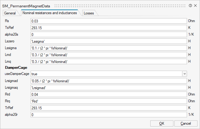

SM_PermanentMagnetData_1
mo_Rs
Rs
Stator resistance per phase at TRef
Scalar
mo_TsRef
TsRef
Reference temperature of stator resistance
Scalar
mo_alpha20s
alpha20s
Temperature coefficient of stator resistance at 20 degC
Scalar
mo_Lszero
Lszero
Stator zero sequence inductance
Scalar
mo_Lssigma
Lssigma
Stator stray inductance per phase
Scalar
mo_Lmd
Lmd
Stator main field inductance per phase in d-axis
Scalar
mo_Lmq
Lmq
Stator main field inductance per phase in q-axis
Scalar
mo_useDamperCage
useDamperCage
Enable / disable damper cage
Scalar
true
false
mo_Lrsigmad
Lrsigmad
Damper stray inductance in d-axis
Scalar
mo_Lrsigmaq
Lrsigmaq
Damper stray inductance in q-axis
Scalar
mo_Rrd
Rrd
Damper resistance in d-axis at TRef
Scalar
mo_Rrq
Rrq
Damper resistance in q-axis at TRef
Scalar
mo_TrRef
TrRef
Reference temperature of damper resistances in d- and q-axis
Scalar
mo_alpha20r
alpha20r
Temperature coefficient of damper resistances in d- and q-axis
Scalar

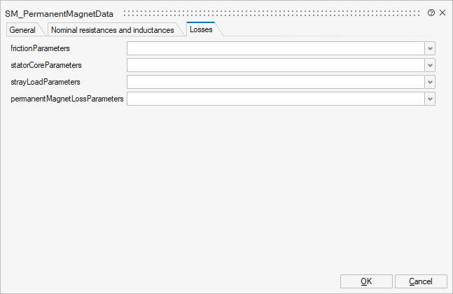

SM_PermanentMagnetData_2
mo_frictionParameters
frictionParameters
Friction loss parameter record
FromModelica('Modelica.Electrical.Machines.Losses.FrictionParameters')
mo_statorCoreParameters
Stator core loss parameter record; all parameters refer to stator side
FromModelica('Modelica.Electrical.Machines.Losses.CoreParameters')
mo_strayLoadParameters
strayLoadParameters
Stray load losses
FromModelica('Modelica.Electrical.Machines.Losses.StrayLoadParameters')
mo_permanentMagnetLossParameters
Permanent magnet loss parameter record
FromModelica('Modelica.Electrical.Machines.Losses.PermanentMagnetLossParameters')
