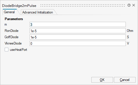

This is a 2*m pulse diode rectifier bridge. In order to operate this rectifier a voltage source with center tap is required. The circuit topology is the same as in Examples.ACDC.RectifierBridge2mPulse. It is important to note that for multi phase circuits with even phase numbers greater than three the MultiStarResistance shall be used for grounding the voltage sources.
mo_RonDiode | RonDiode | Closed diode resistance | Scalar | |
mo_GoffDiode | GoffDiode | Opened diode conductance | Scalar | |
mo_VkneeDiode | VkneeDiode | Diode forward threshold voltage | Scalar | |
mo_T | T | Fixed device temperature if useHeatPort = false | Scalar |

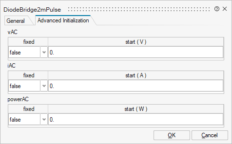

mo_vAC | vAC | vAC | Structure | |
mo_vAC/fixed | fixed | Cell of vectors | true | |
mo_vAC/start | start | Cell of vectors | ||
mo_iAC | iAC | iAC | Structure | |
mo_iAC/fixed | fixed | Cell of vectors | true | |
mo_iAC/start | start | Cell of vectors | ||
mo_powerAC | powerAC | powerAC | Structure | |
mo_powerAC/fixed | fixed | Cell of vectors | true | |
mo_powerAC/start | start | Cell of vectors | ||
