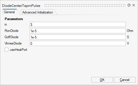

This is a m pulse diode rectifier with center tap. All voltage sources must have one interconnected plug (tap). This rectifiers works only with odd number of phases due the symmetry constrains of even phase numbers implemented in symmetricOrientation. The circuit topology is the same as in Examples.ACDC.RectifierCenterTapmPulse.
mo_RonDiode | RonDiode | Closed diode resistance | Scalar | |
mo_GoffDiode | GoffDiode | Opened diode conductance | Scalar | |
mo_VkneeDiode | VkneeDiode | Diode forward threshold voltage | Scalar | |
mo_T | T | Fixed device temperature if useHeatPort = false | Scalar |

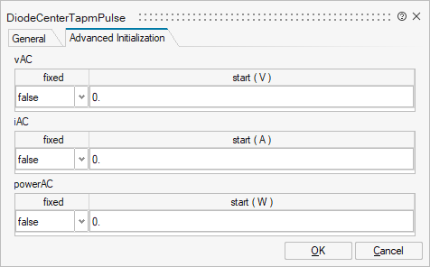

mo_vAC | vAC | vAC | Structure | |
mo_vAC/fixed | fixed | Cell of vectors | true | |
mo_vAC/start | start | Cell of vectors | ||
mo_iAC | iAC | iAC | Structure | |
mo_iAC/fixed | fixed | Cell of vectors | true | |
mo_iAC/start | start | Cell of vectors | ||
mo_powerAC | powerAC | powerAC | Structure | |
mo_powerAC/fixed | fixed | Cell of vectors | true | |
mo_powerAC/start | start | Cell of vectors | ||
