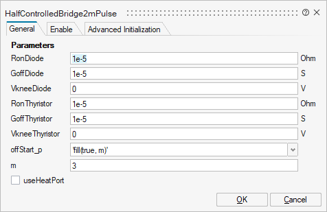

This is a 2*m pulse half controlled rectifier bridge. In order to operate this rectifier a voltage source with center tap is required. The circuit topology is the same as in Examples.ACDC.RectifierBridge2mPulse. It is important to note that for multi phase circuits with even phase numbers greater than three the MultiStarResistance shall be used for grounding the voltage sources.
mo_RonDiode | RonDiode | Closed diode resistance | Scalar | |
mo_GoffDiode | GoffDiode | Opened diode conductance | Scalar | |
mo_VkneeDiode | VkneeDiode | Diode forward threshold voltage | Scalar | |
mo_RonThyristor | RonThyristor | Closed thyristor resistance | Scalar | |
mo_GoffThyristor | GoffThyristor | Opened thyristor conductance | Scalar | |
mo_VkneeThyristor | VkneeThyristor | Thyristor forward threshold voltage | Scalar | |
mo_offStart_p | offStart_p | Boolean start value of variable thyristor_p[:].off | Vector | true |
mo_T | T | Fixed device temperature if useHeatPort = false | Scalar |

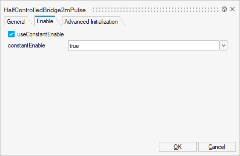

mo_useConstantEnable | useConstantEnable | true = disabled boolean input, use constantEnable | Number | 0 |
mo_constantEnable | constantEnable | Constant enabling of firing signals | Scalar | true |

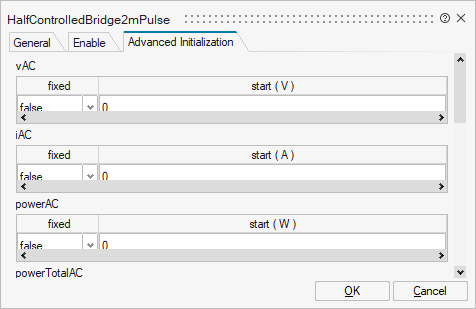

mo_vAC | vAC | vAC | Structure | |
mo_vAC/fixed | fixed | Cell of vectors | true | |
mo_vAC/start | start | Cell of vectors | ||
mo_iAC | iAC | iAC | Structure | |
mo_iAC/fixed | fixed | Cell of vectors | true | |
mo_iAC/start | start | Cell of vectors | ||
mo_powerAC | powerAC | powerAC | Structure | |
mo_powerAC/fixed | fixed | Cell of vectors | true | |
mo_powerAC/start | start | Cell of vectors | ||
mo_powerTotalAC | powerTotalAC | powerTotalAC | Structure | |
mo_powerTotalAC/fixed | fixed | Cell of scalars | true | |
mo_powerTotalAC/start | start | Cell of scalars | ||
mo_vDC | vDC | vDC | Structure | |
mo_vDC/fixed | fixed | Cell of scalars | true | |
mo_vDC/start | start | Cell of scalars | ||
mo_iDC | iDC | iDC | Structure | |
mo_iDC/fixed | fixed | Cell of scalars | true | |
mo_iDC/start | start | Cell of scalars | ||
mo_powerDC | powerDC | powerDC | Structure | |
mo_powerDC/fixed | fixed | Cell of scalars | true | |
mo_powerDC/start | start | Cell of scalars | ||
mo_LossPower | LossPower | LossPower | Structure | |
mo_LossPower/fixed | fixed | Cell of scalars | true | |
mo_LossPower/start | start | Cell of scalars | ||
mo_T_heatPort | T_heatPort | T_heatPort | Structure | |
mo_T_heatPort/fixed | fixed | Cell of scalars | true | |
mo_T_heatPort/start | start | Cell of scalars | ||
mo_fire_p | fire_p | fire_p | Structure | |
mo_fire_p/fixed | fixed | Cell of vectors | true | |
mo_fire_p/start | start | Cell of vectors | ||
mo_enable | enable | enable | Structure | |
mo_enable/fixed | fixed | Cell of scalars | true | |
mo_enable/start | start | Cell of scalars |
