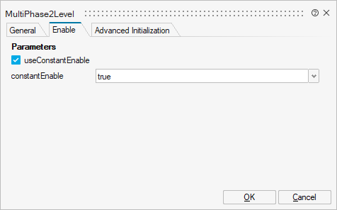

mo_useConstantEnable | useConstantEnable | true = disabled boolean input, use constantEnable | Number | 0 |
mo_constantEnable | constantEnable | Constant enabling of firing signals | Scalar | true |

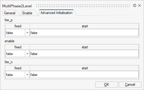

mo_fire_p | fire_p | fire_p | Structure | |
mo_fire_p/fixed | fixed | Cell of vectors | true | |
mo_fire_p/start | start | Cell of vectors | ||
mo_enable | enable | enable | Structure | |
mo_enable/fixed | fixed | Cell of scalars | true | |
mo_enable/start | start | Cell of scalars | ||
mo_fire_n | fire_n | fire_n | Structure | |
mo_fire_n/fixed | fixed | Cell of vectors | true | |
mo_fire_n/start | start | Cell of vectors | ||
