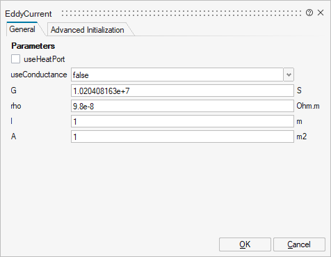

mo_T | T | Fixed device temperature if useHeatPort = false | Scalar | |
mo_useConductance | useConductance | Use conductance instead of geometry data and rho | Scalar | true |
mo_G | G | Equivalent loss conductance G=A/rho/l | Scalar | |
mo_rho | rho | Resistivity of flux tube material (default: Iron at 20degC) | Scalar | |
mo_l | l | Average length of eddy current path | Scalar | |
mo_A | A | Cross sectional area of eddy current path | Scalar | |
mo_R | R | Electrical resistance of eddy current path | Scalar |

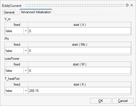

mo_V_m | V_m | V_m | Structure | |
mo_V_m/fixed | fixed | Cell of scalars | true | |
mo_V_m/start | start | Cell of scalars | ||
mo_Phi | Phi | Phi | Structure | |
mo_Phi/fixed | fixed | Cell of scalars | true | |
mo_Phi/start | start | Cell of scalars | ||
mo_LossPower | LossPower | LossPower | Structure | |
mo_LossPower/fixed | fixed | Cell of scalars | true | |
mo_LossPower/start | start | Cell of scalars | ||
mo_T_heatPort | T_heatPort | T_heatPort | Structure | |
mo_T_heatPort/fixed | fixed | Cell of scalars | true | |
mo_T_heatPort/start | start | Cell of scalars |
