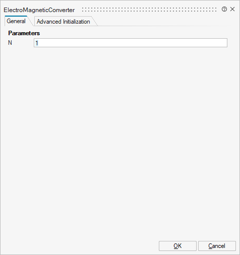

mo_N | N | Number of turns | Scalar |

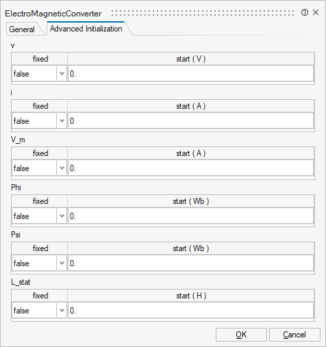

mo_v | v | v | Structure | |
mo_v/fixed | fixed | Cell of scalars | true | |
mo_v/start | start | Cell of scalars | ||
mo_i | i | i | Structure | |
mo_i/fixed | fixed | Cell of scalars | true | |
mo_i/start | start | Cell of scalars | ||
mo_V_m | V_m | V_m | Structure | |
mo_V_m/fixed | fixed | Cell of scalars | true | |
mo_V_m/start | start | Cell of scalars | ||
mo_Phi | Phi | Phi | Structure | |
mo_Phi/fixed | fixed | Cell of scalars | true | |
mo_Phi/start | start | Cell of scalars | ||
mo_Psi | Psi | Psi | Structure | |
mo_Psi/fixed | fixed | Cell of scalars | true | |
mo_Psi/start | start | Cell of scalars | ||
mo_L_stat | L_stat | L_stat | Structure | |
mo_L_stat/fixed | fixed | Cell of scalars | true | |
mo_L_stat/start | start | Cell of scalars |
