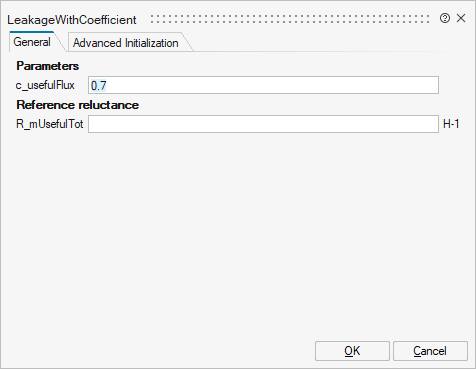

Differently from the flux tube elements of package Shapes.Leakage that are calculated from their geometry, this leakage reluctance is calculated with reference to the total reluctance of a useful flux path. Please refer to the Parameters section for an illustration of the resulting magnetic network. Exploiting Kirchhoff's generalized current law, the leakage reluctance is calculated by means of a coupling coefficient c_usefulFlux.

mo_c_usefulFlux | c_usefulFlux | Ratio useful flux/(leakage flux + useful flux) = useful flux/total flux | Scalar | |
mo_R_mUsefulTot | R_mUsefulTot | Total reluctance of useful flux path as reference | Scalar |

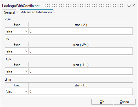

mo_V_m | V_m | V_m | Structure | |
mo_V_m/fixed | fixed | Cell of scalars | true | |
mo_V_m/start | start | Cell of scalars | ||
mo_Phi | Phi | Phi | Structure | |
mo_Phi/fixed | fixed | Cell of scalars | true | |
mo_Phi/start | start | Cell of scalars | ||
mo_R_m | R_m | R_m | Structure | |
mo_R_m/fixed | fixed | Cell of scalars | true | |
mo_R_m/start | start | Cell of scalars | ||
mo_G_m | G_m | G_m | Structure | |
mo_G_m/fixed | fixed | Cell of scalars | true | |
mo_G_m/start | start | Cell of scalars |
