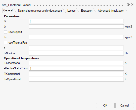

mo_pi | pi | Scalar | ||
mo_m | m | Number of stator phases | Scalar | |
mo_Jr | Jr | Rotor inertia | Scalar | |
mo_useSupport | useSupport | Enable / disable (=fixed stator) support | Number | 0 |
mo_Js | Js | Stator inertia | Scalar | |
mo_useThermalPort | useThermalPort | Enable / disable (=fixed temperatures) thermal port | Number | 0 |
mo_p | p | Number of pole pairs (Integer) | Scalar | |
mo_fsNominal | fsNominal | Nominal frequency | Scalar | |
mo_TsOperational | TsOperational | Operational temperature of stator resistance | Scalar | |
mo_effectiveStatorTurns | effectiveStatorTurns | Effective number of stator turns | Scalar | |
mo_TrOperational | TrOperational | Operational temperature of (optional) damper cage | Scalar | |
mo_TeOperational | TeOperational | Operational excitation temperature | Scalar | |
mo_turnsRatio | turnsRatio | Stator current / excitation current | Scalar | |
mo_Lesigma | Lesigma | Leakage inductance of the excitation winding | Scalar |

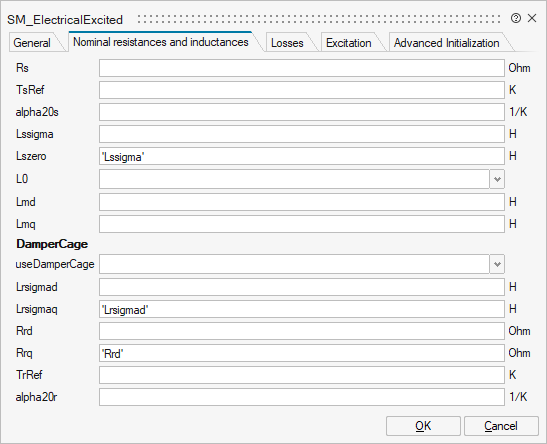

mo_Rs | Rs | Stator resistance per phase at TRef | Scalar | |
mo_TsRef | TsRef | Reference temperature of stator resistance | Scalar | |
mo_alpha20s | alpha20s | Temperature coefficient of stator resistance at 20 degC | Scalar | |
mo_Lssigma | Lssigma | Stator stray inductance | Scalar | |
mo_Lszero | Lszero | Stator zero inductance | Scalar | |
mo_L0 | L0 | Salient inductance of an unchorded coil | FromModelica('Modelica.Magnetic.FundamentalWave.Types.SalientInductance') | |
mo_Lmd | Lmd | Stator main field inductance, d-axis | Scalar | |
mo_Lmq | Lmq | Stator main field inductance, q-axis | Scalar | |
mo_useDamperCage | useDamperCage | Enable/disable damper cage | Scalar | true |
mo_Lrsigmad | Lrsigmad | Rotor leakage inductance, d-axis, w.r.t. stator side | Scalar | |
mo_Lrsigmaq | Lrsigmaq | Rotor leakage inductance, q-axis, w.r.t. stator side | Scalar | |
mo_Rrd | Rrd | Rotor resistance, d-axis, w.r.t. stator side | Scalar | |
mo_Rrq | Rrq | Rotor resistance , q-axis, w.r.t. stator side | Scalar | |
mo_TrRef | TrRef | Reference temperature of damper resistances in d- and q-axis | Scalar | |
mo_alpha20r | alpha20r | Temperature coefficient of damper resistances in d- and q-axis | Scalar |

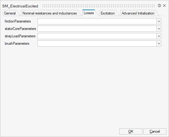

mo_frictionParameters | frictionParameters | Friction loss parameter record | FromModelica('Modelica.Electrical.Machines.Losses.FrictionParameters') | |
mo_statorCoreParameters | statorCoreParameters | Stator core loss parameter record; all parameters refer to stator side | FromModelica('Modelica.Electrical.Machines.Losses.CoreParameters') | |
mo_strayLoadParameters | strayLoadParameters | Stray load loss parameter record | FromModelica('Modelica.Electrical.Machines.Losses.StrayLoadParameters') | |
mo_brushParameters | brushParameters | Brush loss parameter record | FromModelica('Modelica.Electrical.Machines.Losses.BrushParameters') |

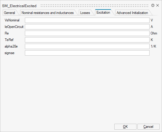

mo_VsNominal | VsNominal | Nominal stator voltage | Scalar | |
mo_IeOpenCircuit | IeOpenCircuit | Open circuit excitation current @ nominal voltage and frequency | Scalar | |
mo_Re | Re | Warm excitation resistance | Scalar | |
mo_TeRef | TeRef | Reference temperature of excitation resistance | Scalar | |
mo_alpha20e | alpha20e | Temperature coefficient of excitation resistance | Scalar | |
mo_sigmae | sigmae | Stray fraction of total excitation inductance | Scalar |

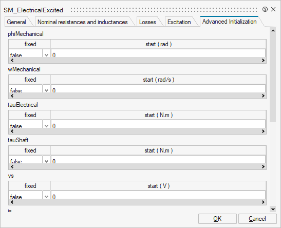

mo_phiMechanical | phiMechanical | phiMechanical | Structure | |
mo_phiMechanical/fixed | fixed | Cell of scalars | true | |
mo_phiMechanical/start | start | Cell of scalars | ||
mo_wMechanical | wMechanical | wMechanical | Structure | |
mo_wMechanical/fixed | fixed | Cell of scalars | true | |
mo_wMechanical/start | start | Cell of scalars | ||
mo_tauElectrical | tauElectrical | tauElectrical | Structure | |
mo_tauElectrical/fixed | fixed | Cell of scalars | true | |
mo_tauElectrical/start | start | Cell of scalars | ||
mo_tauShaft | tauShaft | tauShaft | Structure | |
mo_tauShaft/fixed | fixed | Cell of scalars | true | |
mo_tauShaft/start | start | Cell of scalars | ||
mo_vs | vs | vs | Structure | |
mo_vs/fixed | fixed | Cell of vectors | true | |
mo_vs/start | start | Cell of vectors | ||
mo_is | is | is | Structure | |
mo_is/fixed | fixed | Cell of vectors | true | |
mo_is/start | start | Cell of vectors | ||
mo_ve | ve | ve | Structure | |
mo_ve/fixed | fixed | Cell of scalars | true | |
mo_ve/start | start | Cell of scalars | ||
mo_ie | ie | ie | Structure | |
mo_ie/fixed | fixed | Cell of scalars | true | |
mo_ie/start | start | Cell of scalars | ||
mo_ir | ir | ir | Structure | |
mo_ir/fixed | fixed | Cell of vectors of size 2 | true | |
mo_ir/start | start | Cell of vectors of size 2 | ||
mo_irRMS | irRMS | irRMS | Structure | |
mo_irRMS/fixed | fixed | Cell of scalars | true | |
mo_irRMS/start | start | Cell of scalars |
