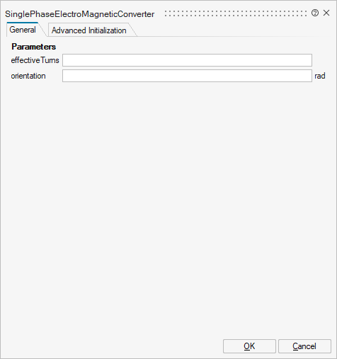

mo_effectiveTurns | effectiveTurns | Effective number of turns | Scalar | |
mo_orientation | orientation | Orientation of the resulting fundamental wave V_m phasor | Scalar | |
mo_N | N | Complex number of turns | Scalar |

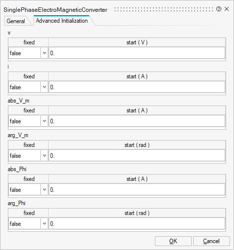

mo_v/start | start | Cell of scalars | ||
mo_i | i | i | Structure | |
mo_i/fixed | fixed | Cell of scalars | true | |
mo_i/start | start | Cell of scalars | ||
mo_abs_V_m | abs_V_m | abs_V_m | Structure | |
mo_abs_V_m/fixed | fixed | Cell of scalars | true | |
mo_abs_V_m/start | start | Cell of scalars | ||
mo_arg_V_m | arg_V_m | arg_V_m | Structure | |
mo_arg_V_m/fixed | fixed | Cell of scalars | true | |
mo_arg_V_m/start | start | Cell of scalars | ||
mo_abs_Phi | abs_Phi | abs_Phi | Structure | |
mo_abs_Phi/fixed | fixed | Cell of scalars | true | |
mo_abs_Phi/start | start | Cell of scalars | ||
mo_arg_Phi | arg_Phi | arg_Phi | Structure | |
mo_arg_Phi/fixed | fixed | Cell of scalars | true | |
mo_arg_Phi/start | start | Cell of scalars |
