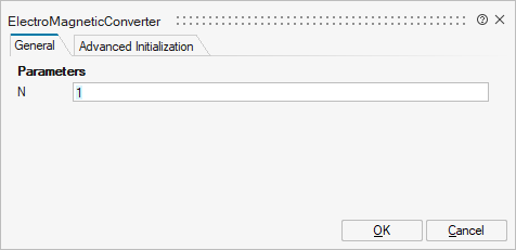

mo_j | j | Scalar | ||
mo_N | N | Number of turns | Scalar |

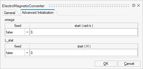

mo_omega | omega | omega | Structure | |
mo_omega/fixed | fixed | Cell of scalars | true | |
mo_omega/start | start | Cell of scalars | ||
mo_L_stat | L_stat | L_stat | Structure | |
mo_L_stat/fixed | fixed | Cell of scalars | true | |
mo_L_stat/start | start | Cell of scalars |
