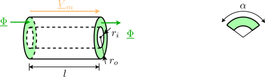

The axial cylinder models is characterized by the outer diameter,
, the inner diameter,
, length,
. The magnetic reluctance is determined by:
The area of cross section yields:
A hollow cylinder is depicted in the above figure left for
. A solid cylindric flux tube an be considered by setting the inner radius,
, equal to zero.
A circular sector of the area of cross section with central angle
is depicted in the above figure right.

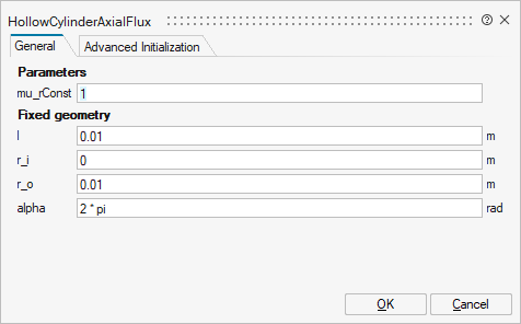

mo_mu_rConst | mu_rConst | Constant relative permeability | Scalar | |
mo_l | l | Axial length (in direction of flux) | Scalar | |
mo_r_i | r_i | Inner radius of hollow cylinder (zero for cylinder) | Scalar | |
mo_r_o | r_o | Outer radius of (hollow) cylinder | Scalar | |
mo_alpha | alpha | Central angle | Scalar |

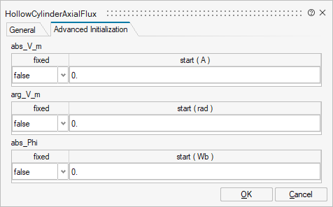

mo_abs_V_m | abs_V_m | abs_V_m | Structure | |
mo_abs_V_m/fixed | fixed | Cell of scalars | true | |
mo_abs_V_m/start | start | Cell of scalars | ||
mo_arg_V_m | arg_V_m | arg_V_m | Structure | |
mo_arg_V_m/fixed | fixed | Cell of scalars | true | |
mo_arg_V_m/start | start | Cell of scalars | ||
mo_abs_Phi | abs_Phi | abs_Phi | Structure | |
mo_abs_Phi/fixed | fixed | Cell of scalars | true | |
mo_abs_Phi/start | start | Cell of scalars | ||
