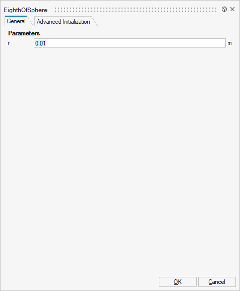

mo_r | r | Radius of eighth of sphere | Scalar |

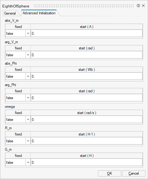

mo_arg_V_m | arg_V_m | arg_V_m | Structure | |
mo_arg_V_m/fixed | fixed | Cell of scalars | true | |
mo_arg_V_m/start | start | Cell of scalars | ||
mo_abs_Phi | abs_Phi | abs_Phi | Structure | |
mo_abs_Phi/fixed | fixed | Cell of scalars | true | |
mo_abs_Phi/start | start | Cell of scalars | ||
mo_arg_Phi | arg_Phi | arg_Phi | Structure | |
mo_arg_Phi/fixed | fixed | Cell of scalars | true | |
mo_arg_Phi/start | start | Cell of scalars | ||
mo_omega | omega | omega | Structure | |
mo_omega/fixed | fixed | Cell of scalars | true | |
mo_omega/start | start | Cell of scalars | ||
mo_R_m | R_m | R_m | Structure | |
mo_R_m/fixed | fixed | Cell of scalars | true | |
mo_R_m/start | start | Cell of scalars | ||
mo_G_m | G_m | G_m | Structure | |
mo_G_m/fixed | fixed | Cell of scalars | true | |
mo_G_m/start | start | Cell of scalars |
