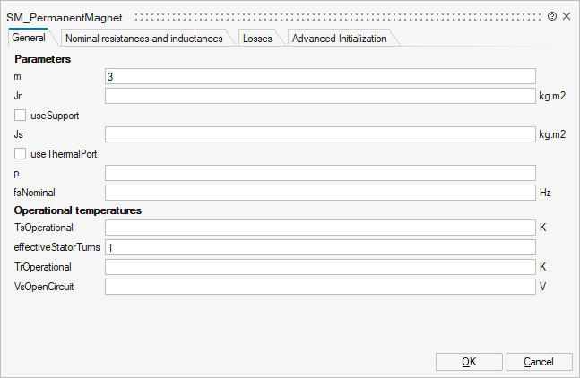

mo_pi | pi | Scalar | ||
mo_m | m | Number of stator phases | Scalar | |
mo_Jr | Jr | Rotor inertia | Scalar | |
mo_useSupport | useSupport | Enable / disable (=fixed stator) support | Number | 0 |
mo_Js | Js | Stator inertia | Scalar | |
mo_useThermalPort | useThermalPort | Enable / disable (=fixed temperatures) thermal port | Number | 0 |
mo_p | p | Number of pole pairs (Integer) | Scalar | |
mo_fsNominal | fsNominal | Nominal frequency | Scalar | |
mo_TsOperational | TsOperational | Operational temperature of stator resistance | Scalar | |
mo_effectiveStatorTurns | effectiveStatorTurns | Effective number of stator turns | Scalar | |
mo_TpmOperational | TpmOperational | Operational temperature of permanent magnet | Scalar | |
mo_TrOperational | TrOperational | Operational temperature of (optional) damper cage | Scalar | |
mo_VsOpenCircuit | VsOpenCircuit | Open circuit RMS voltage per phase @ fsNominal | Scalar | |
mo_V_mPM | V_mPM | Equivalent excitation magnetic potential difference | Scalar |

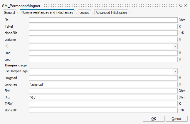

mo_Rs | Rs | Stator resistance per phase at TRef | Scalar | |
mo_TsRef | TsRef | Reference temperature of stator resistance | Scalar | |
mo_alpha20s | alpha20s | Temperature coefficient of stator resistance at 20 degC | Scalar | |
mo_Lssigma | Lssigma | Stator stray inductance per phase | Scalar | |
mo_L0 | L0 | Salient inductance of an unchorded coil | FromModelica('Modelica.Magnetic.FundamentalWave.Types.SalientInductance') | |
mo_Lmd | Lmd | Stator main field inductance per phase, d-axis | Scalar | |
mo_Lmq | Lmq | Stator main field inductance per phase, q-axis | Scalar | |
mo_useDamperCage | useDamperCage | Enable/disable damper cage | Scalar | true |
mo_Lrsigmad | Lrsigmad | Rotor leakage inductance, d-axis, w.r.t. stator side | Scalar | |
mo_Lrsigmaq | Lrsigmaq | Rotor leakage inductance, q-axis, w.r.t. stator side | Scalar | |
mo_Rrd | Rrd | Rotor resistance, d-axis, w.r.t. stator side | Scalar | |
mo_Rrq | Rrq | Rotor resistance , q-axis, w.r.t. stator side | Scalar | |
mo_TrRef | TrRef | Reference temperature of damper resistances in d- and q-axis | Scalar | |
mo_alpha20r | alpha20r | Temperature coefficient of damper resistances in d- and q-axis | Scalar |

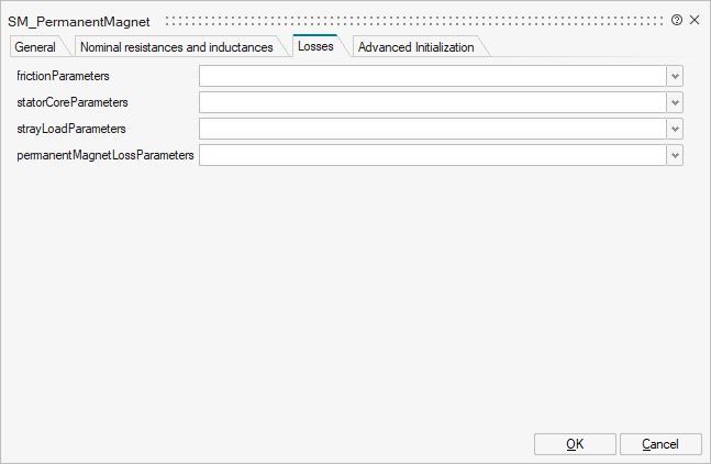

mo_frictionParameters | frictionParameters | Friction loss parameter record | FromModelica('Modelica.Electrical.Machines.Losses.FrictionParameters') | |
mo_statorCoreParameters | statorCoreParameters | Stator core loss parameter record; all parameters refer to stator side | FromModelica('Modelica.Electrical.Machines.Losses.CoreParameters') | |
mo_strayLoadParameters | strayLoadParameters | Stray load loss parameter record | FromModelica('Modelica.Electrical.Machines.Losses.StrayLoadParameters') | |
mo_permanentMagnetLossParameters | permanentMagnetLossParameters | Permanent magnet loss parameter record | FromModelica('Modelica.Electrical.Machines.Losses.PermanentMagnetLossParameters') |

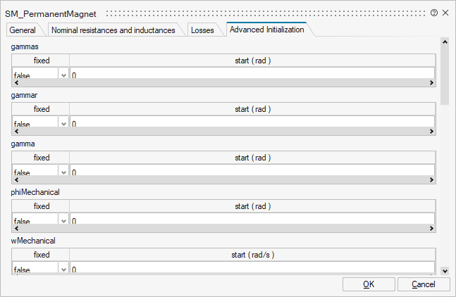

mo_gammas | gammas | gammas | Structure | |
mo_gammas/fixed | fixed | Cell of scalars | true | |
mo_gammas/start | start | Cell of scalars | ||
mo_gammar | gammar | gammar | Structure | |
mo_gammar/fixed | fixed | Cell of scalars | true | |
mo_gammar/start | start | Cell of scalars | ||
mo_gamma | gamma | gamma | Structure | |
mo_gamma/fixed | fixed | Cell of scalars | true | |
mo_gamma/start | start | Cell of scalars | ||
mo_phiMechanical | phiMechanical | phiMechanical | Structure | |
mo_phiMechanical/fixed | fixed | Cell of scalars | true | |
mo_phiMechanical/start | start | Cell of scalars | ||
mo_wMechanical | wMechanical | wMechanical | Structure | |
mo_wMechanical/fixed | fixed | Cell of scalars | true | |
mo_wMechanical/start | start | Cell of scalars | ||
mo_tauElectrical | tauElectrical | tauElectrical | Structure | |
mo_tauElectrical/fixed | fixed | Cell of scalars | true | |
mo_tauElectrical/start | start | Cell of scalars | ||
mo_tauShaft | tauShaft | tauShaft | Structure | |
mo_tauShaft/fixed | fixed | Cell of scalars | true | |
mo_tauShaft/start | start | Cell of scalars | ||
mo_abs_vs | abs_vs | abs_vs | Structure | |
mo_abs_vs/fixed | fixed | Cell of vectors | true | |
mo_abs_vs/start | start | Cell of vectors | ||
mo_arg_vs | arg_vs | arg_vs | Structure | |
mo_arg_vs/fixed | fixed | Cell of vectors | true | |
mo_arg_vs/start | start | Cell of vectors | ||
mo_abs_is | abs_is | abs_is | Structure | |
mo_abs_is/fixed | fixed | Cell of vectors | true | |
mo_abs_is/start | start | Cell of vectors | ||
mo_arg_is | arg_is | arg_is | Structure | |
mo_arg_is/fixed | fixed | Cell of vectors | true | |
mo_arg_is/start | start | Cell of vectors | ||
mo_Ps | Ps | Ps | Structure | |
mo_Ps/fixed | fixed | Cell of vectors | true | |
mo_Ps/start | start | Cell of vectors | ||
mo_Ps_total | Ps_total | Ps_total | Structure | |
mo_Ps_total/fixed | fixed | Cell of scalars | true | |
mo_Ps_total/start | start | Cell of scalars | ||
mo_Qs | Qs | Qs | Structure | |
mo_Qs/fixed | fixed | Cell of vectors | true | |
mo_Qs/start | start | Cell of vectors | ||
mo_Qs_total | Qs_total | Qs_total | Structure | |
mo_Qs_total/fixed | fixed | Cell of scalars | true | |
mo_Qs_total/start | start | Cell of scalars | ||
mo_Ss | Ss | Ss | Structure | |
mo_Ss/fixed | fixed | Cell of vectors | true | |
mo_Ss/start | start | Cell of vectors | ||
mo_Ss_total | Ss_total | Ss_total | Structure | |
mo_Ss_total/fixed | fixed | Cell of scalars | true | |
mo_Ss_total/start | start | Cell of scalars | ||
mo_pfs | pfs | pfs | Structure | |
mo_pfs/fixed | fixed | Cell of vectors | true | |
mo_pfs/start | start | Cell of vectors |
