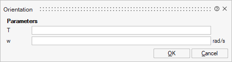

mo_T | T | Transformation matrix from world frame to local frame | Matrix of size 3x3 | |
mo_w | w | Absolute angular velocity of local frame, resolved in local frame | Vector of size 3 |
