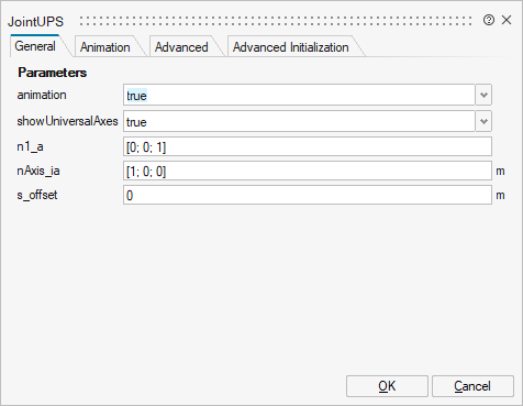

mo_animation | animation | = true, if animation shall be enabled | Scalar | true |
mo_showUniversalAxes | showUniversalAxes | = true, if universal joint shall be visualized with two cylinders, otherwise with a sphere (provided animation=true) | Scalar | true |
mo_n1_a | n1_a | Axis 1 of universal joint resolved in frame_a (axis 2 is orthogonal to axis 1 and to line from universal to spherical joint) | Vector of size 3 | |
mo_nAxis_ia | nAxis_ia | Axis vector along line from origin of frame_a to origin of frame_b, resolved in frame_ia | Vector of size 3 | |
mo_s_offset | s_offset | Relative distance offset (distance between frame_a and frame_b = s(t) + s_offset) | Scalar | |

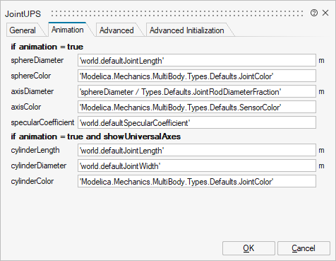

mo_sphereDiameter | sphereDiameter | Diameter of spheres representing the spherical joints | Scalar | |
mo_sphereColor | sphereColor | Color of spheres representing the spherical joints | Vector of size 3 | |
mo_axisDiameter | axisDiameter | Diameter of cylinder on the connecting line from frame_a to frame_b | Scalar | |
mo_axisColor | axisColor | Color of cylinder on the connecting line from frame_a to frame_b | Vector of size 3 | |
mo_specularCoefficient | specularCoefficient | Reflection of ambient light (= 0: light is completely absorbed) | Scalar | |
mo_cylinderLength | cylinderLength | Length of cylinders representing the two universal joint axes | Scalar | |
mo_cylinderDiameter | cylinderDiameter | Diameter of cylinders representing the two universal joint axes | Scalar | |
mo_cylinderColor | cylinderColor | Color of cylinders representing the two universal joint axes | Vector of size 3 |

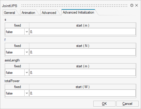

mo_s | s | s | Structure | |
mo_s/fixed | fixed | Cell of scalars | true | |
mo_s/start | start | Cell of scalars | ||
mo_f | f | f | Structure | |
mo_f/fixed | fixed | Cell of scalars | true | |
mo_f/start | start | Cell of scalars | ||
mo_axisLength | axisLength | axisLength | Structure | |
mo_axisLength/fixed | fixed | Cell of scalars | true | |
mo_axisLength/start | start | Cell of scalars | ||
mo_totalPower | totalPower | totalPower | Structure | |
mo_totalPower/fixed | fixed | Cell of scalars | true | |
mo_totalPower/start | start | Cell of scalars |
