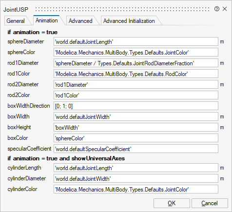

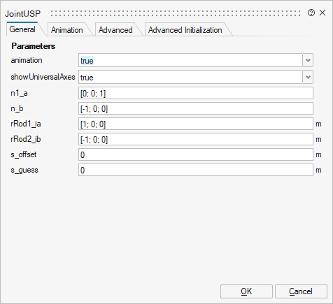

mo_animation | animation | = true, if animation shall be enabled | Scalar | true |
mo_showUniversalAxes | showUniversalAxes | = true, if universal joint shall be visualized with two cylinders, otherwise with a sphere (provided animation=true) | Scalar | true |
mo_n1_a | n1_a | Axis 1 of universal joint fixed and resolved in frame_a (axis 2 is orthogonal to axis 1 and to rod 1) | Vector of size 3 | |
mo_n_b | n_b | Axis of prismatic joint fixed and resolved in frame_b | Vector of size 3 | |
mo_rRod1_ia | rRod1_ia | Vector from origin of frame_a to spherical joint, resolved in frame_ia | Vector of size 3 | |
mo_rRod2_ib | rRod2_ib | Vector from origin of frame_ib to spherical joint, resolved in frame_ib (frame_ib is parallel to frame_b) | Vector of size 3 | |
mo_s_offset | s_offset | Relative distance offset of prismatic joint (distance between the prismatic joint frames = s(t) + s_offset) | Scalar | |
mo_s_guess | s_guess | Select the configuration such that at initial time |s(t0)-s_guess| is minimal | Scalar | |
mo_eRod1_ia | eRod1_ia | Unit vector from origin of frame_a to origin of spherical joint, resolved in frame_ia | Vector of size 3 | |
mo_e2_ia | e2_ia | Unit vector in direction of axis 2 of universal joint, resolved in frame_ia | Vector of size 3 | |
mo_rod1Length | rod1Length | Length of rod 1 (= distance between universal and spherical joint) | Scalar |
mo_sphereDiameter | sphereDiameter | Diameter of the spheres representing the universal and the spherical joint | Scalar | |
mo_sphereColor | sphereColor | Color of the spheres representing the universal and the spherical joint | Vector of size 3 | |
mo_rod1Diameter | rod1Diameter | Diameter of rod 1 connecting the universal and the spherical joint | Scalar | |
mo_rod1Color | rod1Color | Color of rod 1 connecting the universal and the spherical joint | Vector of size 3 | |
mo_rod2Diameter | rod2Diameter | Diameter of rod 2 connecting the prismatic and the spherical joint | Scalar | |
mo_rod2Color | rod2Color | Color of rod 2 connecting the prismatic and the spherical joint | Vector of size 3 | |
mo_boxWidthDirection | boxWidthDirection | Vector in width direction of prismatic joint, resolved in frame_b | Vector of size 3 | |
mo_boxWidth | boxWidth | Width of prismatic joint box | Scalar | |
mo_boxHeight | boxHeight | Height of prismatic joint box | Scalar | |
mo_boxColor | boxColor | Color of prismatic joint box | Vector of size 3 | |
mo_specularCoefficient | specularCoefficient | Reflection of ambient light (= 0: light is completely absorbed) | Scalar | |
mo_cylinderLength | cylinderLength | Length of cylinders representing the two universal joint axes | Scalar | |
mo_cylinderDiameter | cylinderDiameter | Diameter of cylinders representing the two universal joint axes | Scalar | |
mo_cylinderColor | cylinderColor | Color of cylinders representing the two universal joint axes | Vector of size 3 |

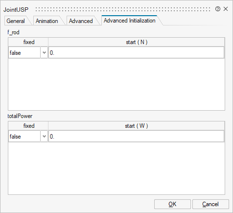

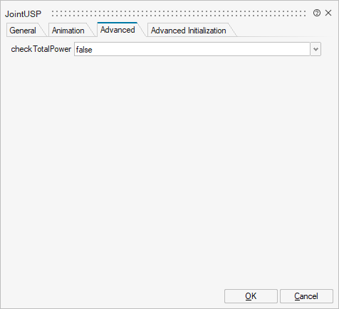

mo_checkTotalPower | checkTotalPower | = true, if total power flowing into this component shall be determined (must be zero) | Scalar | true |
mo_f_rod | f_rod | f_rod | Structure | |
mo_f_rod/fixed | fixed | Cell of scalars | true | |
mo_f_rod/start | start | Cell of scalars | ||
mo_totalPower | totalPower | totalPower | Structure | |
mo_totalPower/fixed | fixed | Cell of scalars | true | |
mo_totalPower/start | start | Cell of scalars |
