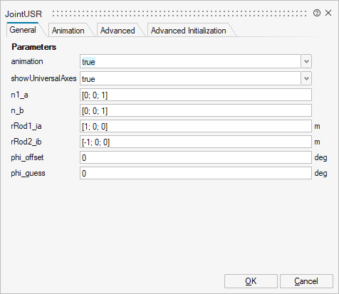

mo_animation | animation | = true, if animation shall be enabled | Scalar | true |
mo_showUniversalAxes | showUniversalAxes | = true, if universal joint shall be visualized with two cylinders, otherwise with a sphere (provided animation=true) | Scalar | true |
mo_n1_a | n1_a | Axis 1 of universal joint fixed and resolved in frame_a (axis 2 is orthogonal to axis 1 and to rod 1) | Vector of size 3 | |
mo_n_b | n_b | Axis of revolute joint fixed and resolved in frame_b | Vector of size 3 | |
mo_rRod1_ia | rRod1_ia | Vector from origin of frame_a to spherical joint, resolved in frame_ia | Vector of size 3 | |
mo_rRod2_ib | rRod2_ib | Vector from origin of frame_ib to spherical joint, resolved in frame_ib | Vector of size 3 | |
mo_phi_offset | phi_offset | Relative angle offset of revolute joint (angle = phi(t) + from_deg(phi_offset)) | Scalar | |
mo_phi_guess | phi_guess | Select the configuration such that at initial time |phi(t0) - from_deg(phi_guess)| is minimal | Scalar | |

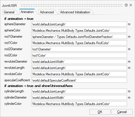

mo_sphereDiameter | sphereDiameter | Diameter of the spheres representing the universal and the spherical joint | Scalar | |
mo_sphereColor | sphereColor | Color of the spheres representing the universal and the spherical joint | Vector of size 3 | |
mo_rod1Diameter | rod1Diameter | Diameter of rod 1 connecting the universal and the spherical joint | Scalar | |
mo_rod1Color | rod1Color | Color of rod 1 connecting the universal and the spherical joint | Vector of size 3 | |
mo_rod2Diameter | rod2Diameter | Diameter of rod 2 connecting the revolute and the spherical joint | Scalar | |
mo_rod2Color | rod2Color | Color of rod 2 connecting the revolute and the spherical joint | Vector of size 3 | |
mo_revoluteDiameter | revoluteDiameter | Diameter of cylinder representing the revolute joint | Scalar | |
mo_revoluteLength | revoluteLength | Length of cylinder representing the revolute joint | Scalar | |
mo_revoluteColor | revoluteColor | Color of cylinder representing the revolute joint | Vector of size 3 | |
mo_specularCoefficient | specularCoefficient | Reflection of ambient light (= 0: light is completely absorbed) | Scalar | |
mo_cylinderLength | cylinderLength | Length of cylinders representing the two universal joint axes | Scalar | |
mo_cylinderDiameter | cylinderDiameter | Diameter of cylinders representing the two universal joint axes | Scalar | |
mo_cylinderColor | cylinderColor | Color of cylinders representing the two universal joint axes | Vector of size 3 |

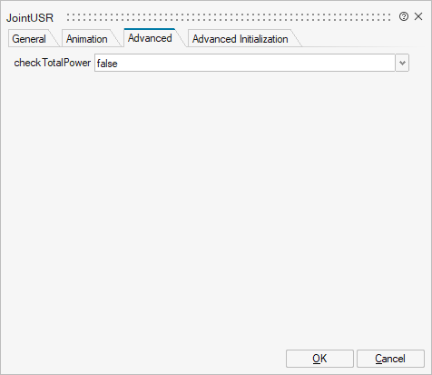

mo_checkTotalPower | checkTotalPower | = true, if total power flowing into this component shall be determined (must be zero) | Scalar | true |

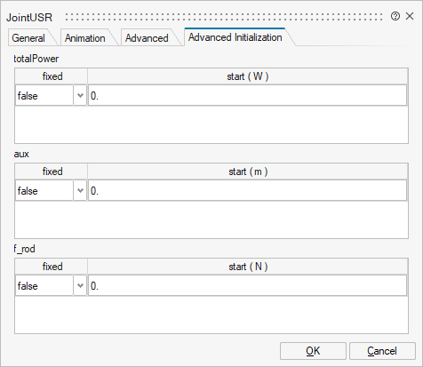

mo_totalPower | totalPower | totalPower | Structure | |
mo_totalPower/fixed | fixed | Cell of scalars | true | |
mo_totalPower/start | start | Cell of scalars | ||
mo_aux | aux | aux | Structure | |
mo_aux/fixed | fixed | Cell of scalars | true | |
mo_aux/start | start | Cell of scalars | ||
mo_f_rod | f_rod | f_rod | Structure | |
mo_f_rod/fixed | fixed | Cell of scalars | true | |
mo_f_rod/start | start | Cell of scalars |
