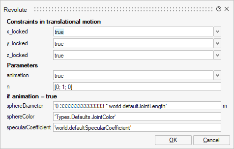

Revolute
Revolute cut-joint and translational directions may be constrained or released
    Revolute
Modelica/Mechanics/MultiBody/Joints/Constraints
This model does not use explicit variables e.g. state variables in order to describe the relative motion of frame_b with respect to frame_a, but defines kinematic constraints between the frame_a and frame_b. The forces and torques at both frames are then evaluated in such a way that the constraints are satisfied. Sometimes this type of formulation is also called an implicit joint in literature.
As a consequence of the formulation the relative kinematics between frame_a and frame_b cannot be initialized.
In particular in complex multibody systems with closed loops this may help to simplify the system of non-linear equations. Please compare the translation log using the classical joint formulation and the alternative formulation used here in order to check whether this fact applies to the particular system under consideration.
In systems without closed loops the use of this implicit joint does not make sense or may even be disadvantageous.
See the subpackage Examples.Constraints for testing the joint.
Revolute_0
mo_x_locked
x_locked
= true: constraint force in x-direction, resolved in frame_a
Scalar
true
false
mo_y_locked
y_locked
= true: constraint force in y-direction, resolved in frame_a
Scalar
true
false
mo_z_locked
z_locked
= true: constraint force in z-direction, resolved in frame_a
Scalar
true
false
mo_animation
animation
= true, if animation shall be enabled (show sphere)
Scalar
true
false
mo_n
n
Axis of rotation resolved in frame_a (= same as in frame_b)
Vector of size 3
mo_sphereDiameter
sphereDiameter
Diameter of sphere representing the spherical joint
Scalar
mo_sphereColor
sphereColor
Color of sphere representing the spherical joint
Vector of size 3
mo_specularCoefficient
specularCoefficient
Reflection of ambient light (= 0: light is completely absorbed)
Scalar
mo_e
e
Unit vector in direction of rotation axis, resolved in frame_a (= same as in frame_b)
Vector of size 3
mo_nnx_a
nnx_a
Arbitrary vector that is not aligned with rotation axis n
Vector of size 3
mo_ey_a
ey_a
Unit vector orthogonal to axis n of revolute joint, resolved in frame_a
Vector of size 3
mo_ex_a
ex_a
Unit vector orthogonal to axis n of revolute joint and to ey_a, resolved in frame_a
Vector of size 3
