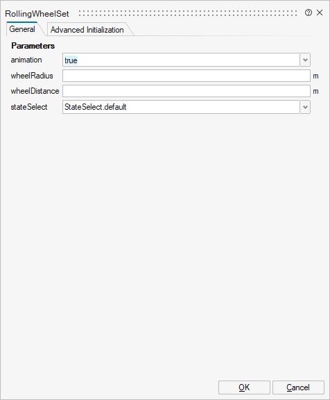

mo_animation | animation | = true, if animation of wheel set shall be enabled | Scalar | true |
mo_wheelRadius | wheelRadius | Radius of one wheel | Scalar | |
mo_wheelDistance | wheelDistance | Distance between the two wheels | Scalar | |
mo_stateSelect | stateSelect | Priority to use the generalized coordinates as states | Structure | |
mo_stateSelect/choice1 | StateSelect.never | Number | 0 | |
mo_stateSelect/choice2 | StateSelect.avoid | Number | 0 | |
mo_stateSelect/choice3 | StateSelect.default | Number | 0 | |
mo_stateSelect/choice4 | StateSelect.prefer | Number | 0 | |
mo_stateSelect/choice5 | StateSelect.always | Number | 0 |

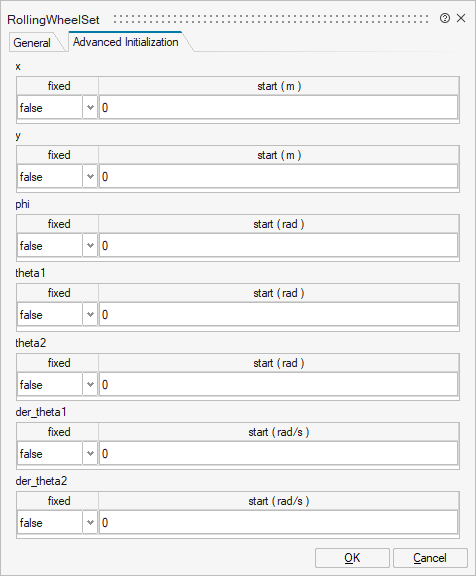

mo_x | x | x | Structure | |
mo_x/fixed | fixed | Cell of scalars | true | |
mo_x/start | start | Cell of scalars | ||
mo_y | y | y | Structure | |
mo_y/fixed | fixed | Cell of scalars | true | |
mo_y/start | start | Cell of scalars | ||
mo_phi | phi | phi | Structure | |
mo_phi/fixed | fixed | Cell of scalars | true | |
mo_phi/start | start | Cell of scalars | ||
mo_theta1 | theta1 | theta1 | Structure | |
mo_theta1/fixed | fixed | Cell of scalars | true | |
mo_theta1/start | start | Cell of scalars | ||
mo_theta2 | theta2 | theta2 | Structure | |
mo_theta2/fixed | fixed | Cell of scalars | true | |
mo_theta2/start | start | Cell of scalars | ||
mo_der_theta1 | der_theta1 | der_theta1 | Structure | |
mo_der_theta1/fixed | fixed | Cell of scalars | true | |
mo_der_theta1/start | start | Cell of scalars | ||
mo_der_theta2 | der_theta2 | der_theta2 | Structure | |
mo_der_theta2/fixed | fixed | Cell of scalars | true | |
mo_der_theta2/start | start | Cell of scalars | ||
