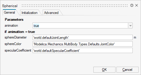

In the following figure the animation of a spherical joint is shown. The light blue coordinate system is frame_a and the dark blue coordinate system is frame_b of the joint. (here: angles_start = {45, 45, 45}o).
mo_animation | animation | = true, if animation shall be enabled (show sphere) | Scalar | true |
mo_sphereDiameter | sphereDiameter | Diameter of sphere representing the spherical joint | Scalar | |
mo_sphereColor | sphereColor | Color of sphere representing the spherical joint | Vector of size 3 | |
mo_specularCoefficient | specularCoefficient | Reflection of ambient light (= 0: light is completely absorbed) | Scalar | |

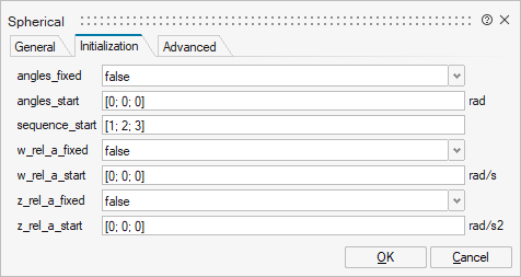

mo_angles_fixed | angles_fixed | = true, if angles_start are used as initial values, else as guess values | Scalar | true |
mo_angles_start | angles_start | Initial values of angles to rotate frame_a around 'sequence_start' axes into frame_b | Vector of size 3 | |
mo_sequence_start | sequence_start | Sequence of rotations to rotate frame_a into frame_b at initial time | Vector of size 3 | |
mo_w_rel_a_fixed | w_rel_a_fixed | = true, if w_rel_a_start are used as initial values, else as guess values | Scalar | true |
mo_w_rel_a_start | w_rel_a_start | Initial values of angular velocity of frame_b with respect to frame_a, resolved in frame_a | Vector of size 3 | |
mo_z_rel_a_fixed | z_rel_a_fixed | = true, if z_rel_a_start are used as initial values, else as guess values | Scalar | true |
mo_z_rel_a_start | z_rel_a_start | Initial values of angular acceleration z_rel_a = der(w_rel_a) | Vector of size 3 |

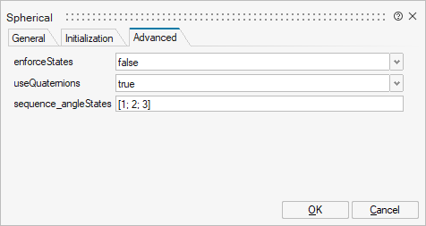

mo_enforceStates | enforceStates | = true, if relative variables of spherical joint shall be used as states (StateSelect.always) | Scalar | true |
mo_useQuaternions | useQuaternions | = true, if quaternions shall be used as states otherwise use 3 angles as states (provided enforceStates=true) | Scalar | true |
mo_sequence_angleStates | sequence_angleStates | Sequence of rotations to rotate frame_a into frame_b around the 3 angles used as states | Vector of size 3 |
