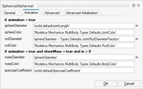

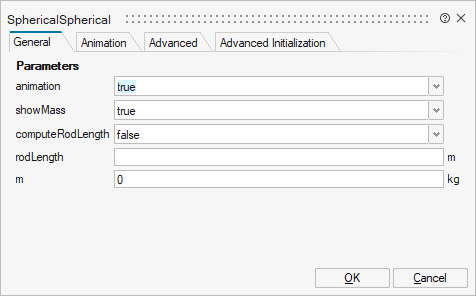

mo_animation | animation | = true, if animation shall be enabled | Scalar | true |
mo_showMass | showMass | = true, if mass shall be shown (provided animation = true and m > 0) | Scalar | true |
mo_computeRodLength | computeRodLength | = true, if rodLength shall be computed during initialization (see info) | Scalar | true |
mo_rodLength | rodLength | Distance between the origins of frame_a and frame_b (if computeRodLength=true, guess value) | Scalar | |
mo_m | m | Mass of rod (= point mass located in middle of rod) | Scalar |
mo_sphereDiameter | sphereDiameter | Diameter of spheres representing the spherical joints | Scalar | |
mo_sphereColor | sphereColor | Color of spheres representing the spherical joints | Vector of size 3 | |
mo_rodDiameter | rodDiameter | Diameter of rod connecting the two spherical joint | Scalar | |
mo_rodColor | rodColor | Color of rod connecting the two spherical joints | Vector of size 3 | |
mo_massDiameter | massDiameter | Diameter of sphere representing the mass point | Scalar | |
mo_massColor | massColor | Color of sphere representing the mass point | Vector of size 3 | |
mo_specularCoefficient | specularCoefficient | Reflection of ambient light (= 0: light is completely absorbed) | Scalar |

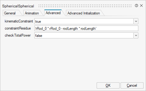

mo_kinematicConstraint | kinematicConstraint | = false, if no constraint shall be defined, due to analytically solving a kinematic loop ("false" should not be used by user, but only by MultiBody.Joints.Assemblies joints) | Scalar | true |
mo_constraintResidue | constraintResidue | Constraint equation of joint in residue form: Either length constraint (= default) or equation to compute rod force (for analytic solution of loops in combination with Internal.RevoluteWithLengthConstraint/PrismaticWithLengthConstraint) | Scalar | |
mo_checkTotalPower | checkTotalPower | = true, if total power flowing into this component shall be determined (must be zero) | Scalar | true |

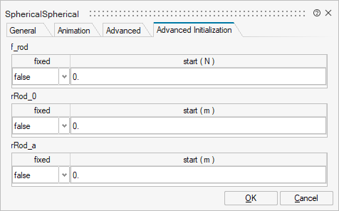

mo_f_rod | f_rod | f_rod | Structure | |
mo_f_rod/fixed | fixed | Cell of scalars | true | |
mo_f_rod/start | start | Cell of scalars | ||
mo_rRod_0 | rRod_0 | rRod_0 | Structure | |
mo_rRod_0/fixed | fixed | Cell of vectors of size 3 | true | |
mo_rRod_0/start | start | Cell of vectors of size 3 | ||
mo_rRod_a | rRod_a | rRod_a | Structure | |
mo_rRod_a/fixed | fixed | Cell of vectors of size 3 | true | |
mo_rRod_a/start | start | Cell of vectors of size 3 | ||
