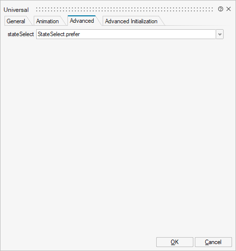

They are used as candidates for automatic selection of states from the tool. This may be enforced by setting "stateSelect=StateSelect.always" in the Advanced menu. The states are usually selected automatically. In certain situations, especially when closed kinematic loops are present, it might be slightly more efficient, when using the "StateSelect.always" setting.

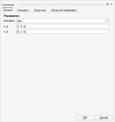

mo_animation | animation | = true, if animation shall be enabled | Scalar | true |
mo_n_a | n_a | Axis of revolute joint 1 resolved in frame_a | Vector of size 3 | |
mo_n_b | n_b | Axis of revolute joint 2 resolved in frame_b | Vector of size 3 |

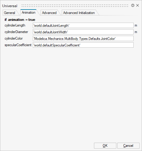

mo_cylinderLength | cylinderLength | Length of cylinders representing the joint axes | Scalar | |
mo_cylinderDiameter | cylinderDiameter | Diameter of cylinders representing the joint axes | Scalar | |
mo_cylinderColor | cylinderColor | Color of cylinders representing the joint axes | Vector of size 3 | |
mo_specularCoefficient | specularCoefficient | Reflection of ambient light (= 0: light is completely absorbed) | Scalar |
mo_stateSelect | stateSelect | Priority to use joint coordinates (phi_a, phi_b, w_a, w_b) as states | Structure | |
mo_stateSelect/choice1 | StateSelect.never | Number | 0 | |
mo_stateSelect/choice2 | StateSelect.avoid | Number | 0 | |
mo_stateSelect/choice3 | StateSelect.default | Number | 0 | |
mo_stateSelect/choice4 | StateSelect.prefer | Number | 0 | |
mo_stateSelect/choice5 | StateSelect.always | Number | 0 |

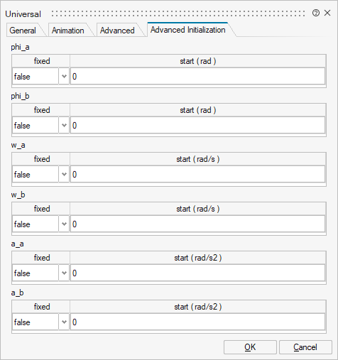

mo_revolute_a | revolute_a | revolute_a | Structure | |
mo_revolute_a/fixed | fixed | Cell of scalars | ||
mo_revolute_b | revolute_b | revolute_b | Structure | |
mo_revolute_b/fixed | fixed | Cell of scalars | ||
mo_phi_a | phi_a | phi_a | Structure | |
mo_phi_a/fixed | fixed | Cell of scalars | true | |
mo_phi_a/start | start | Cell of scalars | ||
mo_phi_b | phi_b | phi_b | Structure | |
mo_phi_b/fixed | fixed | Cell of scalars | true | |
mo_phi_b/start | start | Cell of scalars | ||
mo_w_a | w_a | w_a | Structure | |
mo_w_a/fixed | fixed | Cell of scalars | true | |
mo_w_a/start | start | Cell of scalars | ||
mo_w_b | w_b | w_b | Structure | |
mo_w_b/fixed | fixed | Cell of scalars | true | |
mo_w_b/start | start | Cell of scalars | ||
mo_a_a | a_a | a_a | Structure | |
mo_a_a/fixed | fixed | Cell of scalars | true | |
mo_a_a/start | start | Cell of scalars | ||
mo_a_b | a_b | a_b | Structure | |
mo_a_b/fixed | fixed | Cell of scalars | true | |
mo_a_b/start | start | Cell of scalars |
