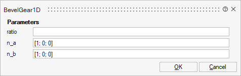

This component is used to model a 1-dim. gearbox
with non-parallel axes (defined by parameters n_a, n_b).
A 3-dim. bearing frame is necessary to reflect the
correct support torque, as the axes of rotation of flange_a and
flange_b and the direction of the support torque vector
are different in general.
Note: The name BevelGear1D is kept only for simplicity. Regardless, this component could be used to model any kind of gearbox with non-parallel axes. For a usage example, see Examples.Rotational3DEffects.BevelGear1D.

mo_ratio | ratio | Gear speed ratio | Scalar | |
mo_n_a | n_a | Axis of rotation of flange_a, resolved in frame_a | Vector of size 3 | |
mo_n_b | n_b | Axis of rotation of flange_b, resolved in frame_a | Vector of size 3 | |
mo_e_a | e_a | Unit vector in direction of flange_a rotation axis | Vector of size 3 | |
mo_e_b | e_b | Unit vector in direction of flange_b rotation axis | Vector of size 3 |
