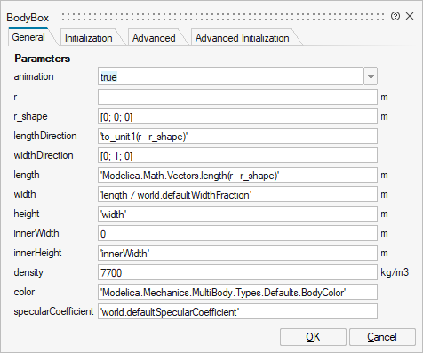

mo_animation | animation | = true, if animation shall be enabled (show box between frame_a and frame_b) | Scalar | true |
mo_r | r | Vector from frame_a to frame_b resolved in frame_a | Vector of size 3 | |
mo_r_shape | r_shape | Vector from frame_a to box origin, resolved in frame_a | Vector of size 3 | |
mo_lengthDirection | lengthDirection | Vector in length direction of box, resolved in frame_a | Vector of size 3 | |
mo_widthDirection | widthDirection | Vector in width direction of box, resolved in frame_a | Vector of size 3 | |
mo_length | length | Length of box | Scalar | |
mo_width | width | Width of box | Scalar | |
mo_height | height | Height of box | Scalar | |
mo_innerWidth | innerWidth | Width of inner box surface (0 <= innerWidth <= width) | Scalar | |
mo_innerHeight | innerHeight | Height of inner box surface (0 <= innerHeight <= height) | Scalar | |
mo_density | density | Density of cylinder (e.g., steel: 7700 .. 7900, wood : 400 .. 800) | Scalar | |
mo_color | color | Color of box | Vector of size 3 | |
mo_specularCoefficient | specularCoefficient | Reflection of ambient light (= 0: light is completely absorbed) | Scalar | |
mo_mo | mo | Mass of box without hole | Scalar | |
mo_mi | mi | Mass of hole of box | Scalar | |
mo_m | m | Mass of box | Scalar | |
mo_R | R | Orientation object from frame_a to coordinates system spanned by r and widthDirection | FromModelica('Modelica.Mechanics.MultiBody.Frames.Orientation') | |
mo_r_CM | r_CM | Position vector from origin of frame_a to center of mass, resolved in frame_a | Vector of size 3 | |
mo_I | I | Inertia tensor of body box with respect to center of mass, parallel to frame_a | Matrix of size 3x3 |

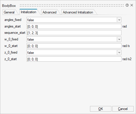

mo_angles_fixed | angles_fixed | = true, if angles_start are used as initial values, else as guess values | Scalar | true |
mo_angles_start | angles_start | Initial values of angles to rotate frame_a around 'sequence_start' axes into frame_b | Vector of size 3 | |
mo_sequence_start | sequence_start | Sequence of rotations to rotate frame_a into frame_b at initial time | Vector of size 3 | |
mo_w_0_fixed | w_0_fixed | = true, if w_0_start are used as initial values, else as guess values | Scalar | true |
mo_w_0_start | w_0_start | Initial or guess values of angular velocity of frame_a resolved in world frame | Vector of size 3 | |
mo_z_0_fixed | z_0_fixed | = true, if z_0_start are used as initial values, else as guess values | Scalar | true |
mo_z_0_start | z_0_start | Initial values of angular acceleration z_0 = der(w_0) | Vector of size 3 |

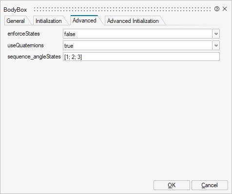

mo_enforceStates | enforceStates | = true, if absolute variables of body object shall be used as states (StateSelect.always) | Scalar | true |
mo_useQuaternions | useQuaternions | = true, if quaternions shall be used as potential states otherwise use 3 angles as potential states | Scalar | true |
mo_sequence_angleStates | sequence_angleStates | Sequence of rotations to rotate world frame into frame_a around the 3 angles used as potential states | Vector of size 3 |

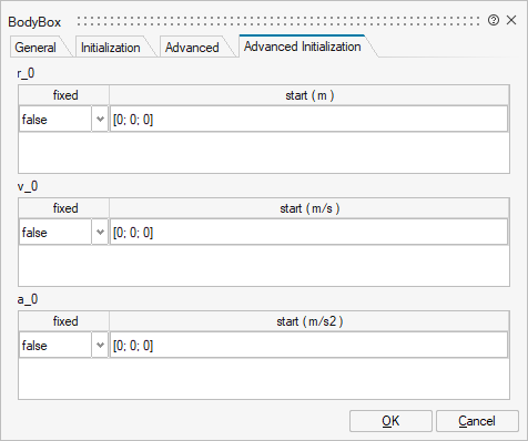

mo_r_0 | r_0 | r_0 | Structure | |
mo_r_0/fixed | fixed | Cell of vectors of size 3 | true | |
mo_r_0/start | start | Cell of vectors of size 3 | ||
mo_v_0 | v_0 | v_0 | Structure | |
mo_v_0/fixed | fixed | Cell of vectors of size 3 | true | |
mo_v_0/start | start | Cell of vectors of size 3 | ||
mo_a_0 | a_0 | a_0 | Structure | |
mo_a_0/fixed | fixed | Cell of vectors of size 3 | true | |
mo_a_0/start | start | Cell of vectors of size 3 |
