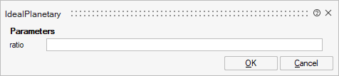

mo_ratio | ratio | Number of ring_teeth/sun_teeth (e.g., ratio=100/50) | Scalar |
