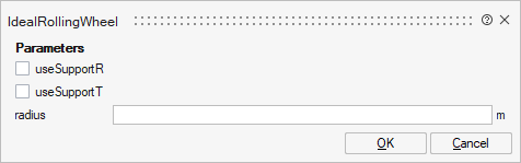

IdealRollingWheel
Simple 1-dim. model of an ideal rolling wheel without inertia
Modelica/Mechanics/Rotational/Components
A simple kinematic model of a rolling wheel which has no inertia and no rolling resistance. This component defines the kinematic constraint:
(flangeR.phi - internalSupportR.phi)*wheelRadius = (flangeT.s - internalSupportT.s);
mo_useSupportR | useSupportR | = true, if rotational support flange enabled, otherwise implicitly grounded | Number | 0 |
mo_useSupportT | useSupportT | = true, if translational support flange enabled, otherwise implicitly grounded | Number | 0 |
mo_radius | radius | Wheel radius | Scalar |
flangeR | implicit | Flange of rotational shaft | input | 1 |
flangeT | implicit | Flange of translational rod | output | 1 |
Port 3 | implicit | Rotational support/housing of component | input | mo_useSupportR |
Port 4 | implicit | Translational support/housing of component | input | mo_useSupportT |
