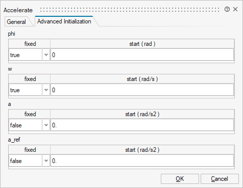

mo_useSupport | useSupport | = true, if support flange enabled, otherwise implicitly grounded | Number | 0 |
mo_phi | phi | phi | Structure | |
mo_phi/fixed | fixed | Cell of scalars | true | |
mo_phi/start | start | Cell of scalars | ||
mo_w | w | w | Structure | |
mo_w/fixed | fixed | Cell of scalars | true | |
mo_w/start | start | Cell of scalars | ||
mo_a | a | a | Structure | |
mo_a/fixed | fixed | Cell of scalars | true | |
mo_a/start | start | Cell of scalars | ||
mo_a_ref | a_ref | a_ref | Structure | |
mo_a_ref/fixed | fixed | Cell of scalars | true | |
mo_a_ref/start | start | Cell of scalars |
