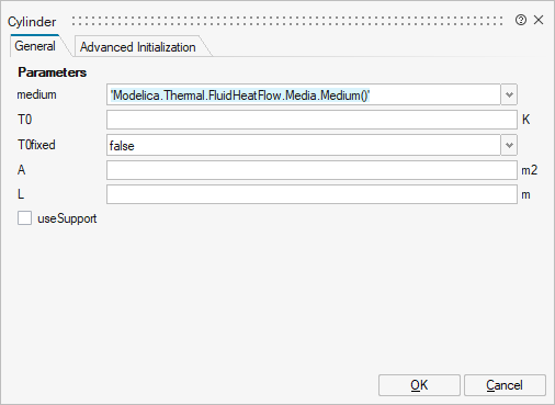

mo_medium | medium | Medium | FromModelica('Modelica.Thermal.FluidHeatFlow.Media.Medium') | |
mo_T0 | T0 | Initial temperature of medium | Scalar | |
mo_T0fixed | T0fixed | Initial temperature guess value or fixed | Scalar | true |
mo_Exchange | Exchange | Exchange of medium via flowport | Scalar | true |
mo_A | A | Cross section of cylinder/piston | Scalar | |
mo_L | L | Length of cylinder | Scalar | |
mo_useSupport | useSupport | = true, if support flange enabled, otherwise implicitly grounded | Number | 0 |

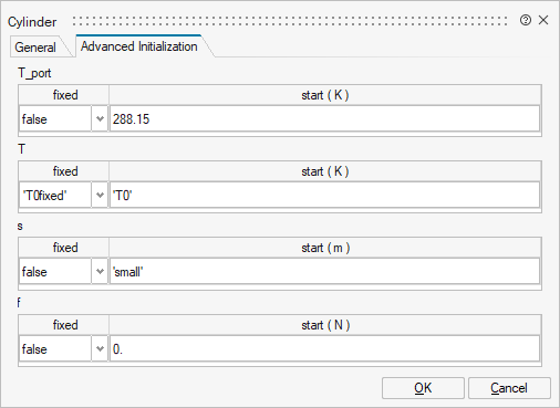

mo_T_port | T_port | T_port | Structure | |
mo_T_port/fixed | fixed | Cell of scalars | true | |
mo_T_port/start | start | Cell of scalars | ||
mo_T | T | T | Structure | |
mo_T/fixed | fixed | Cell of scalars | true | |
mo_T/start | start | Cell of scalars | ||
mo_s | s | s | Structure | |
mo_s/fixed | fixed | Cell of scalars | true | |
mo_s/start | start | Cell of scalars | ||
mo_f | f | f | Structure | |
mo_f/fixed | fixed | Cell of scalars | true | |
mo_f/start | start | Cell of scalars |
