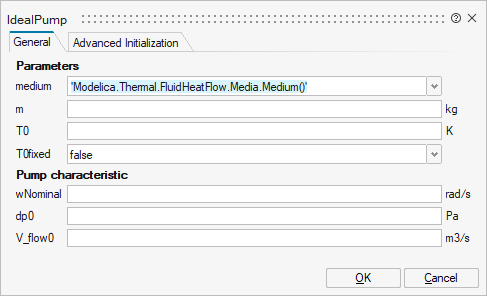

mo_medium | medium | Medium in the component | FromModelica('Modelica.Thermal.FluidHeatFlow.Media.Medium') | |
mo_m | m | Mass of medium | Scalar | |
mo_T0 | T0 | Initial temperature of medium | Scalar | |
mo_T0fixed | T0fixed | Initial temperature guess value or fixed | Scalar | true |
mo_tapT | tapT | Defines temperature of heatPort between inlet and outlet temperature | Scalar | |
mo_wNominal | wNominal | Nominal speed | Scalar | |
mo_dp0 | dp0 | Max. pressure increase @ V_flow=0 | Scalar | |
mo_V_flow0 | V_flow0 | Max. volume flow rate @ dp=0 | Scalar |

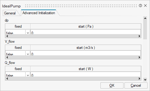

mo_dp | dp | dp | Structure | |
mo_dp/fixed | fixed | Cell of scalars | true | |
mo_dp/start | start | Cell of scalars | ||
mo_V_flow | V_flow | V_flow | Structure | |
mo_V_flow/fixed | fixed | Cell of scalars | true | |
mo_V_flow/start | start | Cell of scalars | ||
mo_Q_flow | Q_flow | Q_flow | Structure | |
mo_Q_flow/fixed | fixed | Cell of scalars | true | |
mo_Q_flow/start | start | Cell of scalars | ||
mo_T | T | T | Structure | |
mo_T/fixed | fixed | Cell of scalars | true | |
mo_T/start | start | Cell of scalars | ||
mo_T_a | T_a | T_a | Structure | |
mo_T_a/fixed | fixed | Cell of scalars | true | |
mo_T_a/start | start | Cell of scalars | ||
mo_T_b | T_b | T_b | Structure | |
mo_T_b/fixed | fixed | Cell of scalars | true | |
mo_T_b/start | start | Cell of scalars | ||
mo_dT | dT | dT | Structure | |
mo_dT/fixed | fixed | Cell of scalars | true | |
mo_dT/start | start | Cell of scalars | ||
mo_T_q | T_q | T_q | Structure | |
mo_T_q/fixed | fixed | Cell of scalars | true | |
mo_T_q/start | start | Cell of scalars | ||
mo_w | w | w | Structure | |
mo_w/fixed | fixed | Cell of scalars | true | |
mo_w/start | start | Cell of scalars |
