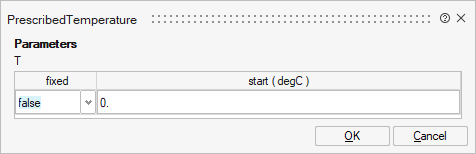

PrescribedTemperature
Variable temperature boundary condition in degCelsius
Modelica/Thermal/HeatTransfer/Celsius
This model represents a variable temperature boundary condition The temperature value in [degC] is given by the input signal to the model. The effect is that an instance of this model acts as an infinite reservoir able to absorb or generate as much energy as required to keep the temperature at the specified value.
mo_T | T | T | Structure | |
mo_T/fixed | fixed | Cell of scalars | true | |
mo_T/start | start | Cell of scalars |
port | implicit | output | 1 | |
T | implicit | input | 1 |
