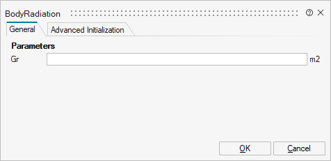

mo_Gr | Gr | Net radiation conductance between two surfaces (see docu) | Scalar |

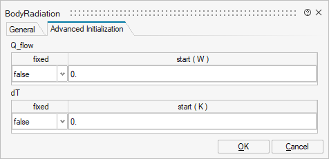

mo_Q_flow/start | start | Cell of scalars | ||
mo_dT | dT | dT | Structure | |
mo_dT/fixed | fixed | Cell of scalars | true | |
mo_dT/start | start | Cell of scalars |
