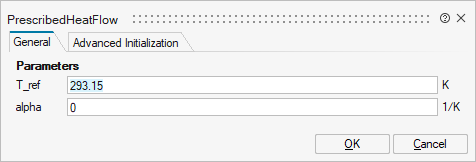

If parameter alpha is <> 0, the heat flow is multiplied by (1 + alpha*(port.T - T_ref)) in order to simulate temperature dependent losses (which are given with respect to reference temperature T_ref).
mo_T_ref | T_ref | Reference temperature | Scalar | |
mo_alpha | alpha | Temperature coefficient of heat flow rate | Scalar |

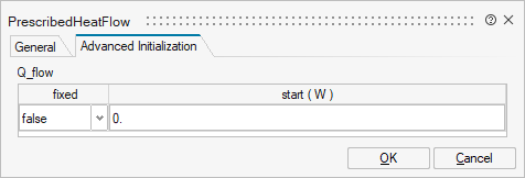

mo_Q_flow | Q_flow | Q_flow | Structure | |
mo_Q_flow/fixed | fixed | Cell of scalars | true | |
mo_Q_flow/start | start | Cell of scalars |
