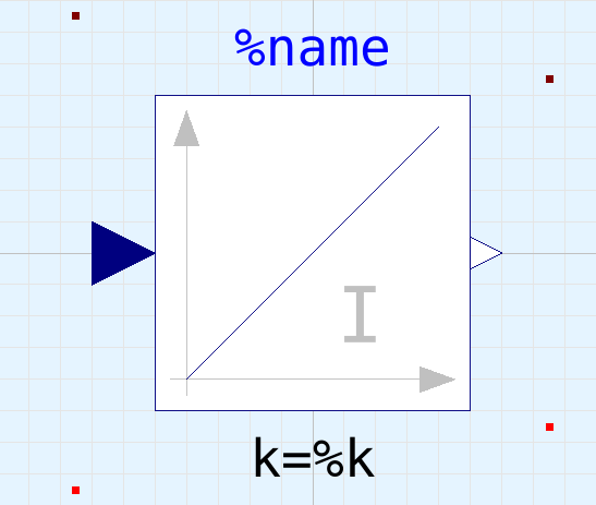

If possible, the icon shall be designed such way, that the icon name %name
and the most significant parameter can be displayed within the vertical Diagram range of the icon.
(a)
(b) ![]()
Fig. 1: (a) Typical icon, (b) including dimensions
Component Name
The component name %name shall be in RGB (0,0,255) blue color.
- Text height: 40 units
- Text width: 300 units
The text shall be located above the actual icon. If there is enough space, the upper text limit of the component name shall be 10 units below the upper icon boundary, see Fig. 1.
If the icon is as big as the entire icon range of 200 units x 200 units, e.g. in blocks, the component name shall be placed above the icon with vertical 10 units of space between icon and lower text box, see Fig. 2.
