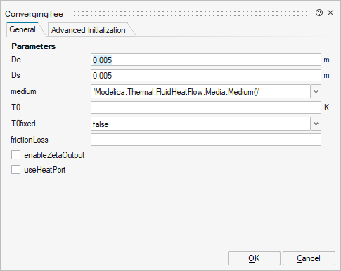

mo_Dc | Dc | Diameter of main passage | Scalar | |
mo_Ds | Ds | Diameter of branch | Scalar | |
mo_medium | medium | Medium in the component | FromModelica('Modelica.Thermal.FluidHeatFlow.Media.Medium') | |
mo_T0 | T0 | Initial temperature of medium | Scalar | |
mo_T0fixed | T0fixed | Initial temperature guess value or fixed | Scalar | true |
mo_frictionLoss | frictionLoss | Part of friction losses fed to medium | Scalar | |
mo_enableZetaOutput | enableZetaOutput | Enable zeta output | Number | 0 |
mo_useHeatPort | useHeatPort | Enable HeatPort | Number | 0 |

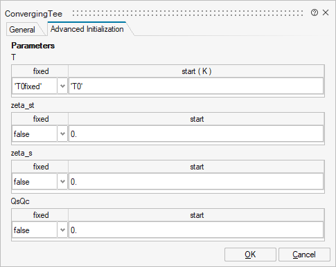

mo_T | T | T | Structure | |
mo_T/fixed | fixed | Cell of scalars | true | |
mo_T/start | start | Cell of scalars | ||
mo_zeta_st | zeta_st | zeta_st | Structure | |
mo_zeta_st/fixed | fixed | Cell of scalars | true | |
mo_zeta_st/start | start | Cell of scalars | ||
mo_zeta_s | zeta_s | zeta_s | Structure | |
mo_zeta_s/fixed | fixed | Cell of scalars | true | |
mo_zeta_s/start | start | Cell of scalars | ||
mo_QsQc | QsQc | QsQc | Structure | |
mo_QsQc/fixed | fixed | Cell of scalars | true | |
mo_QsQc/start | start | Cell of scalars |
