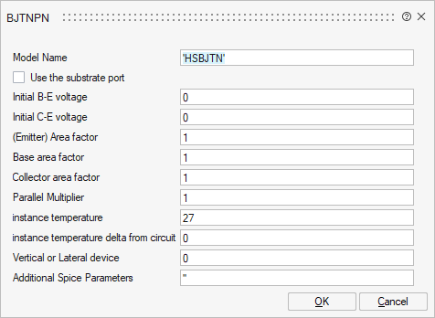

sp_mname | Model Name | String | ||
sp_needsubstrate | Use the substrate port | A bipolar may have a fourth node called substrate port. | Number | 0 |
sp_icvbe | Initial B-E voltage | Initial Base-Emitter voltage. | Scalar | |
sp_icvce | Initial C-E voltage | Initial Collector-Emitter voltage. | Scalar | |
sp_area | (Emitter) Area factor | Junction area but used to scale any pn junction. | Scalar | |
sp_areab | Base area factor | Junction area but used to scale any pn junction. | Scalar | |
sp_areac | Collector area factor | Junction area but used to scale any pn junction. | Scalar | |
sp_m | Parallel Multiplier | Multiplier for setting ‘m’ bipolars in parallel. | Scalar | |
sp_temp | instance temperature | The temperature at which the device is operating. | Scalar | |
sp_dtemp | instance temperature delta from circuit | Temperature variation relative to the simulation temperature. | Scalar | |
sp_subs | Vertical or Lateral device | Type of the BJT structure: Vertical (1), Lateral (0). | Scalar | |
sp_Spice | Additional Spice Parameters | For more details, see the section | String |
