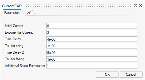

The CurrentExp is a time-dependent exponential current source.Parameters
sp_EXP | EXP | String | ||
sp_I0 | Initial Current | Initial current value (amperes) | Scalar | |
sp_I1 | Exponential Current | Exponential current value (amperes) | Scalar | |
sp_Td1 | Time Delay 1 | Rise-time delay | Scalar | |
sp_Tau1 | Tau for rising | Rise-time constant | Scalar | |
sp_Td2 | Time Delay 2 | Fall-time delay | Scalar | |
sp_Tau2 | Tau for falling | Fall-time constant | Scalar | |
sp_Spice | Additional Spice Parameters | For more details, see the section | String |

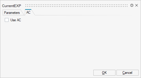

use_ac | Use AC | Check this parameter to set the AC parameters | Number | 0 |
ac_magnitude | AC Magnitude | Value of the AC current source | Scalar | |
ac_phase | AC Phase | Value of the AC phase | Scalar |
