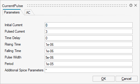

The PulseCurrent is a periodic source with two current level. The current changes from the initial current to the pulsed value providing a square current signal.
The transition time should also be specified in order to provide realistic signal.
sp_PULSE | PULSE | String | ||
sp_I0 | Initial Current | Initial current (amperes) | Scalar | |
sp_I1 | Pulsed Current | Pulse currentb (amperes) | Scalar | |
sp_Td | Time Delay | Initial delay time (seconds) | Scalar | |
sp_Rt | Rising Time | Rise time (seconds) | Scalar | |
sp_Ft | Falling Time | Fall time (seconds) | Scalar | |
sp_Tw | Pulse Width | Pulse Width (seconds) | Scalar | |
sp_Tp | Period | Period (seconds) | Scalar | |
sp_Spice | Additional Spice Parameters | For more details, see the section | String |

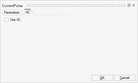

use_ac | Use AC | Check this parameter to set the AC parameters | Number | 0 |
ac_magnitude | AC Magnitude | Value of the AC current source | Scalar | |
ac_phase | AC Phase | Value of the AC phase | Scalar |
