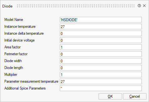

sp_mname | Model Name | For more details, see the section | String | |
sp_temp | Instance temperature | The temperature at which the diode is operating (degrees Celcius) | Scalar | |
sp_dtemp | Instance delta temperature | Temperature variation relative to the simulation temperature (degrees Celcius) | Scalar | |
sp_ic | Initial device voltage | Initial diode voltage (volts) | Scalar | |
sp_area | Area factor | Junction area used to scale any pn junction (square meter). <p> | Scalar | |
sp_pj | Perimeter factor | Perimeter factor | Scalar | |
sp_w | Diode width | Junction width (meter) | Scalar | |
sp_l | Diode length | Junction length (meter) | Scalar | |
sp_m | Multiplier | Scale factor | Scalar | |
sp_tnom | Parameter measurement temperature | Instance operating temperature (degrees Celsius) | Scalar | |
sp_Spice | Additional Spice Parameters | For more details, see the section | String |
