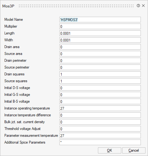

sp_mname | Model Name | Name of the MOS model | String | |
sp_m | Multiplier | Multiplier for setting m mosfets in parallel | Scalar | |
sp_l | Length | Channel length (meter) | Scalar | |
sp_w | Width | Channel width (meter) | Scalar | |
sp_ad | Drain area | Drain area (square meter) | Scalar | |
sp_as | Source area | Source area (square meter) | Scalar | |
sp_pd | Drain perimeter | Drain perimeter (meter) | Scalar | |
sp_ps | Source perimeter | Source perimeter (meter) | Scalar | |
sp_nrd | Drain squares | Equivalent number of squares of the drain diffusion | Scalar | |
sp_nrs | Source squares | Equivalent number of squares of the source diffusion | Scalar | |
sp_icvds | Initial D-S voltage | Initial drain source voltage (volts) | Scalar | |
sp_icvgs | Initial G-S voltage | Initial gate source voltage (volts) | Scalar | |
sp_icvbs | Initial B-S voltage | Initial bulk source voltage (volts) | Scalar | |
sp_temp | Instance operating temperature | The temperature at which the mosfet is operating (degrees Celsius) | Scalar | |
sp_dtemp | Instance temperature difference | Temperature variation relative to the simulation temperature (Degress Celsius) | Scalar | |
sp_js | Bulk jct. sat. current density | Bulk junction saturation current density | Scalar | |
sp_delvto | Threshold voltage Adjust | The threshold voltage is defined as the gate voltage above which the transistor becomes conductive due to an inversion of a thin layer (volts) | Scalar | |
sp_tnom | Parameter measurement temperature | This parameter describes the process of measuring a current local temperature | Scalar | |
sp_Spice | Additional Spice Parameters | For more details, see the section | String |
