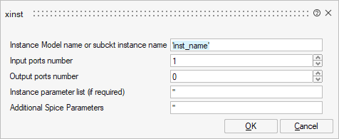

A subcircuit definition contains Spice circuit elements, has a name and specifies the circuit nodes that connect it to the main circuit.
The Xinst device allows to refer to a model or a subcircuit.
sp_mname | Instance Model name or subckt instance name | Name of the model or the subcircuit | String | |
sp_nbiports | Input ports number | Number of inputs | Number | |
sp_nboports | Output ports number | Number of outputs | Number | |
sp_options | Instance parameter list (if required) | List of parameters passed to the instance | String | |
sp_Spice | Additional Spice Parameters | For more details, see the section | String |
Port 1 | implicit | input | sp_nbiports | |
Port 2 | implicit | input | sp_nboports |
