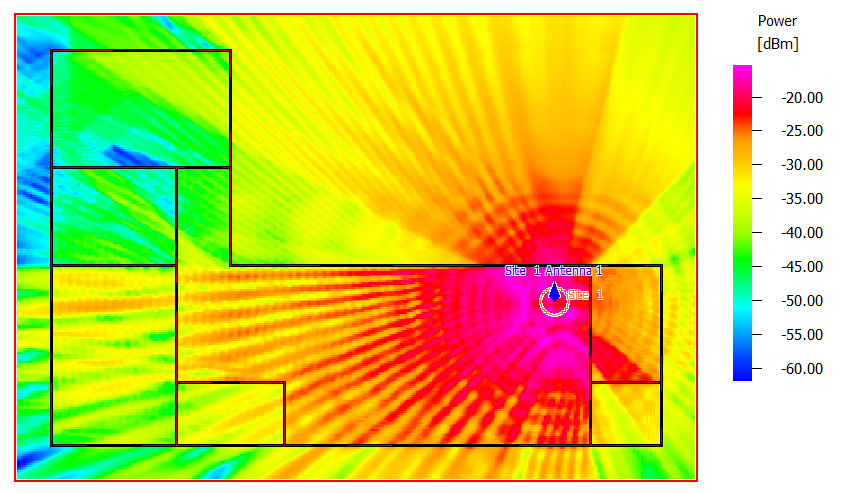

Viewing the Prediction Results in 2D
Display the power results using the 3D ray tracing (SRT) model.
