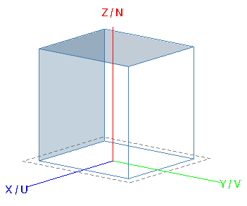

Add a near field boundary request to the model. This type of request allows you to
define a cuboidal near field request where the request points are located on the surface of
the cuboid, but you have the option to exclude specific surfaces (faces).
Figure 1. An example of a Cartesian boundary near field request with only the +N
surface and -V surface included (faces shown in blue).

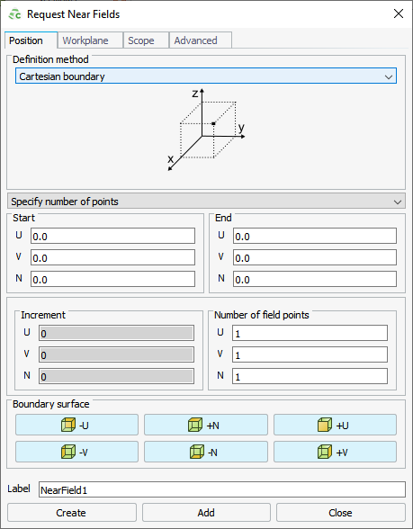

On the Request tab, in the
Solution Requests group, click the Near Fields
icon.
Figure 2. The Request Near Fields dialog.
Under Definition method, from the drop-down list, select Cartesian
boundary.
In the drop-down list, select one of the following:
To specify the start and end points and the number of field points,
select Specify number of points.
To specify the start and end points and the increment between points,
select Specify increments.
Tip: The actual end point (depends on the start point, the
number of field points and increment) may not coincide with the
specified end point.
Under Boundary surface, click the applicable button if
you want to exclude a surface from the Cartesian boundary near field request.
Click on one or more of the following to exclude:
-U: Exclude the surface in the negative U
direction.
+N: Exclude the surface in the positive N
direction.
+U: Exclude the surface in the positive U
direction.
-V: Exclude the surface in the negative V
direction.
-N: Exclude the surface in the negative N
direction.
+V: Exclude the surface in the positive V
direction.
In the Label field, add a unique label for the
request.
Click Create to request the near field result and
to close the dialog.
