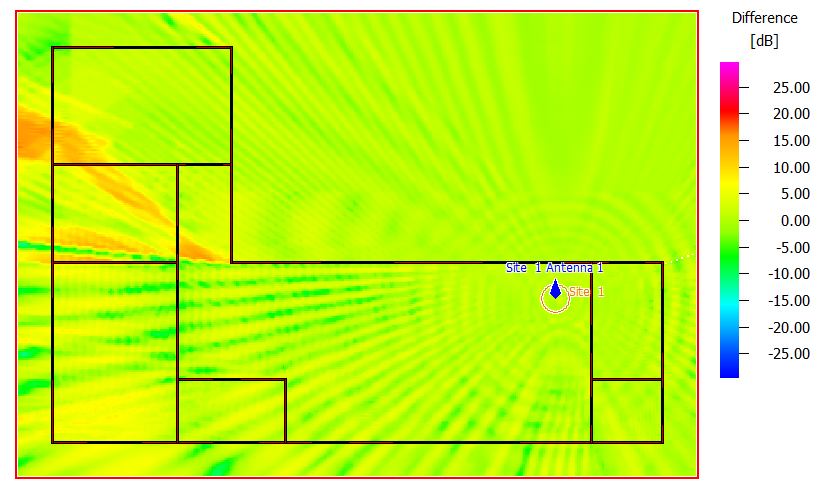

Viewing the Differences in Prediction Results
Display the difference between the two sets of prediction results obtained using the multi-wall model (COST 231) and the 3D ray tracing (SRT) model.
