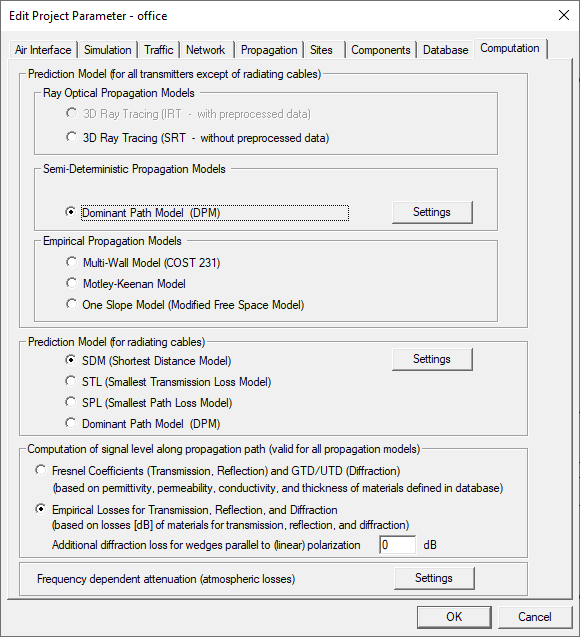

Specifying the Computation Method
The indoor database is solved using the dominant path model (DPM)
