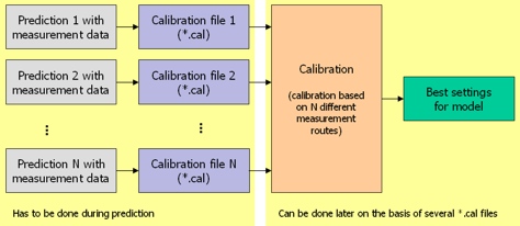

The following picture shows the procedure for the calibration of the propagation models:
Figure 1. Flow diagram illustrating the procedure for calibration of propagation models.
As shown in the picture, during the prediction calibration files are written to the hard disk. The calibration is done afterwards based on the calibration files (.cal). The steps for the calibration are explained in the following sections.

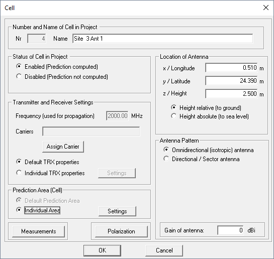

To retrieve a calibration file (.cal) after the prediction, a measurement file has to be assigned to the corresponding transmitter. Only one measurement route can be assigned to one transmitter. In the image below it is shown how a measurement file can be assigned to a transmitter.
Figure 2. Assigning a measurement file to a transmitter.
The Measurements button is used to assign a measurement file (.fpp, .fpl, .fpf files are supported) to the selected transmitter. The measurement file must contain measured data from the selected transmitter only. Superposed measurement data from several transmitters is not supported. When the measurement data is in path loss format (.fpl) cable loss must not be included. In contrast to this, cable loss is expected as “included” when measurement data is available in field strength or power file format. Antenna gain is always expected as “included”.

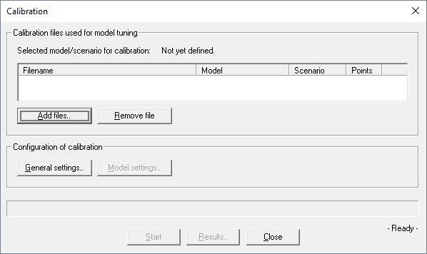

The calibration tool can be started from the Computation menu (). The calibration files generated during the wave propagation prediction have to be added to the list. This is shown in the image below.
Figure 3. Adding calibration files for wave propagation prediction.
Files can be added by clicking on Add files. They can be deleted by clicking on Remove file.

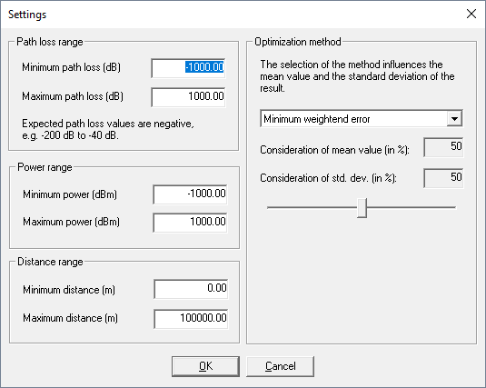

The settings can be adapted to the users needs by selecting General settings. This allows you to influence the selection of the measurement points, only points in a given power (dBm), path loss (dB) or distance (m) range will be considered.
Figure 4. The Settings dialog.
- Minimum mean error
- The goal of the optimization is to achieve a minimum mean error (nearest to zero). The standard deviation is not considered and thus might be larger.
- Minimum mean squared error
- The goal of the optimization is to achieve a minimum mean squared error. The standard deviation is not considered and thus might be larger.
- Minimum standard deviation:
- The goal of the optimization is to achieve a minimum standard deviation. The mean error is not considered and thus might be larger.
- Minimum weighted error
- The goal of the optimization is to find the best combination of minimum mean error and minimum standard deviation. The weighting between mean error and standard deviation can be adapted by the user.

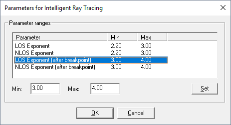

The range of the model parameters can be defined in the Model settings tab. As larger the range is, as longer the calibration will take. The model parameters depend on the selected propagation model, each model offers individual model parameters.
Figure 5. The Parameters for Intelligent Ray Tracing dialog.
The model parameters can be modified on the dialog. Depending on the propagation model the material database or the clutter/land usage database can be calibrated additionally. After clicking on Start, the calibration begins and the progress is shown with a progress bar. In some cases the calibration process does take up to 1 hour.

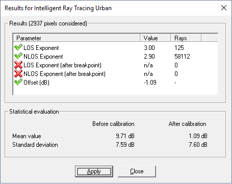

After a calibration has finished the results are displayed in a table.
Figure 6. Example of calibration results. for intelligent ray-tracing urban.
The model parameters listed in the table can now be transferred manually into the project settings of ProMan and the project can be recomputed to achieve better results based on the new model parameters. By clicking on Apply, the material properties (as far as they have been calibrated) are applied to the vector / material database.
The message box shown above gives also information about mean value and standard deviation from measurements to predictions before and after the calibration. Depending on the optimization method different results can be obtained.
