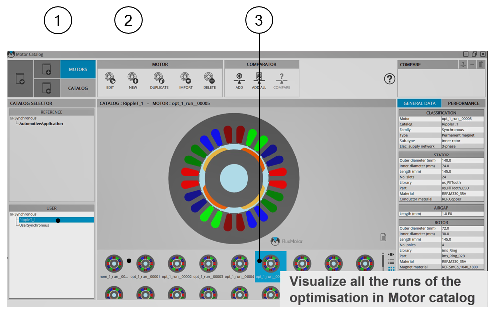

All the motors resulting from the operations performed with Altair® HyperStudy® can be used back in Motor Catalog of Altair® FluxMotor®, and then these can be edited in Motor Factory very quickly.
| Motor Catalog – Visualization of results got from HyperStudy® | |
| 1 | A catalog is automatically built by using the name of the connector defined by the user |
| 2 | All the operations from HyperStudy® are stored in the dedicated catalog |
| 3 | Each motor can be selected, visualized and edited in the Motor Factory, to be evaluated more in depth |

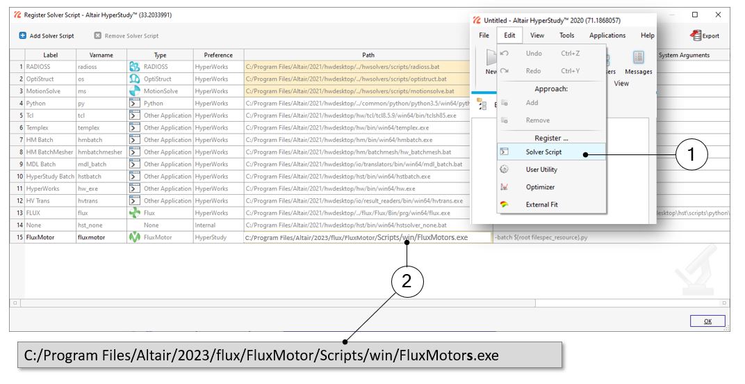

2. Connection between FluxMotor® and HyperStudy®
Before starting new studies in HyperStudy® by using connectors exported from FluxMotor®, FluxMotor must be registered as a new solver script in HyperStudy®.
This must be defined only while using the coupling for the first time.
| Connection between FluxMotor® and HyperStudy® | |
| 1 | Open the area in HyperStudy® to register FluxMotor 2023.1 script |
| 2 | Path where FluxMotor.exe must be selected to be registered as a new
solver in HyperStudy®. Note: FluxMotor
s .exe with a “s” at the end of FluxMotor
s. This must be defined only while using the
Note: Since the
version 2022.1 of HyperStudy, the FluxMotor solver script is
automatically registered, when the default path installation is selected
while installing Flux and FluxMotor.

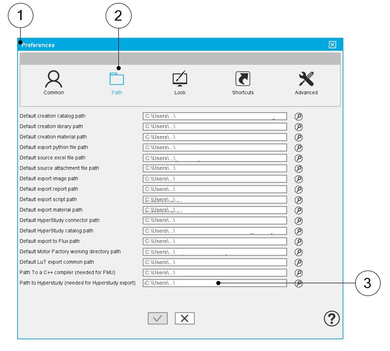

| Path to HyperStudy – Needed for HyperStudy export – It must be defined in the user preferences (Supervisor of FluxMotor) |
