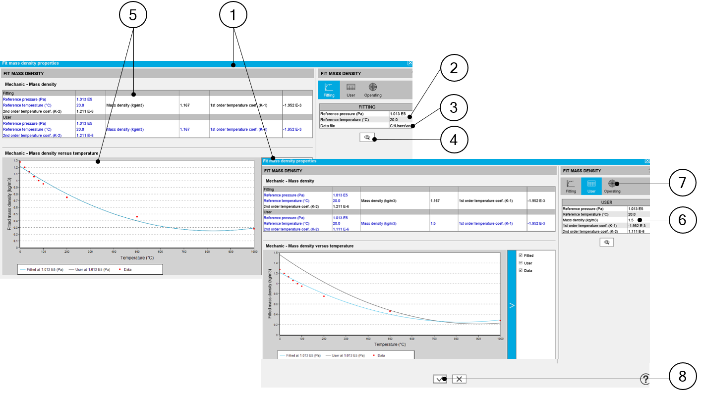

Identification of the air mass density curve
characteristics (for instance) |
1 |
Dialog box allowing the characterization of the density curve imported
from an Excel file |
2 |
Select the reference conditions (temperature and pressure) associated
with the measures contained in the Excel file. |
3 |
Path where Excel file containing the measures is stored. See an example
of Excel file below. |
4 |
Click on this button to import the Excel data. |
5 |
When importing an Excel file, points representing the density curve are
listed, an optimization process automatically computes and displays the
corresponding characteristics.
Three curves are displayed:
6 |
Indeed, going to the tab “User” the user can adjust one or all the main
parameters of the density curve.
7 |
It is possible to select an operating pressure to visualize the behavior
of the resulting mass density curve. Operating pressure should be chosen in
“Operating” tab. Note: If the chosen pressure is not
the same than the ones used for the fitting process, the measurement
points (in red) will not be displayed.
8 |
Lastly the parameters, written in the input fields are validated when the
user clicks on this button.
It is possible to cancel the creation of the density curve model. In this
case, the previous values defined before opening this dialog box are
reset.

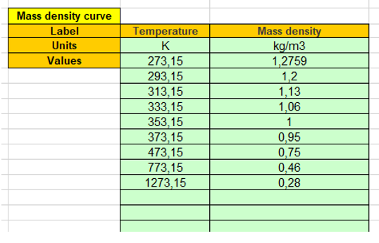

Example of an Excel file to define the mass density curve
parameters.
Example of an Excel file to define the air mass density
curve parameters |
